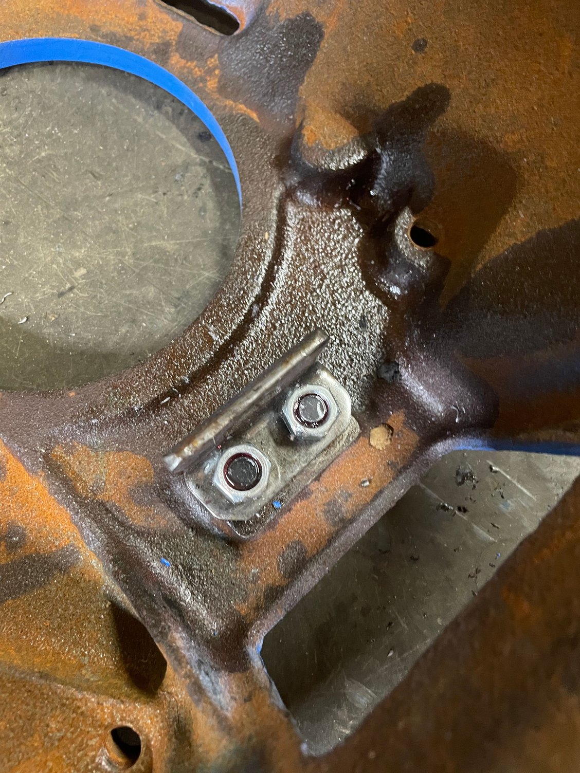

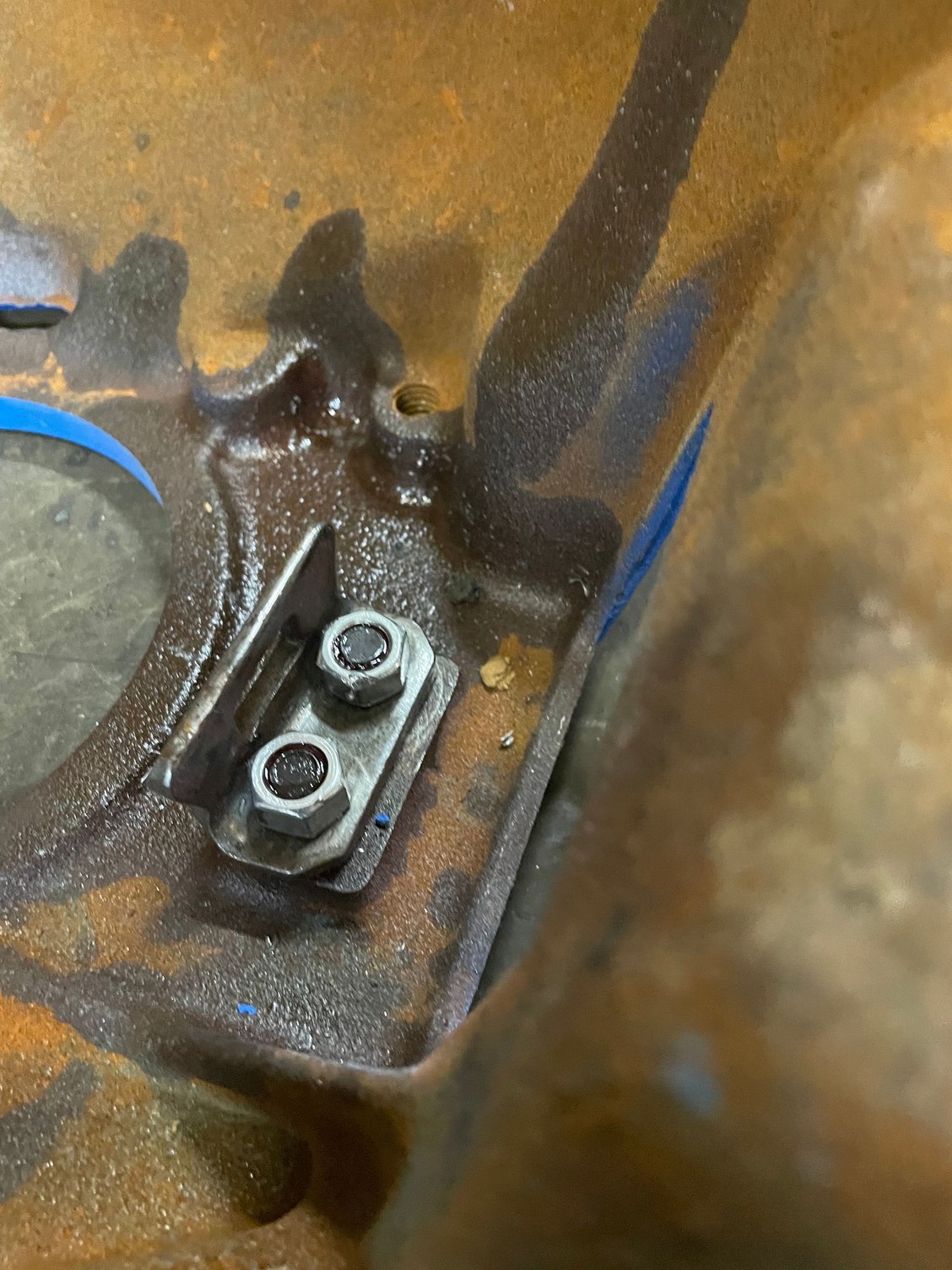

These clutches can take a lot of abuse and still run. My TO bearing also hanging loose and the fork retainer spring was broken off.

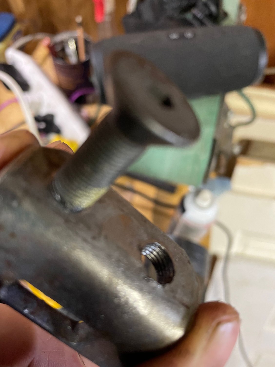

Since the fulcrum/pivot was very wobbly, I tapped the bell and pivot for 3/8-24 fine thread and used counter-sunk screws, with red loctite, washers and nuts.
Not going anywhere!

Seems like re-securing the pivot mount is a no-brainer. I'm so glad I looked here before reassembling. Thanks!
