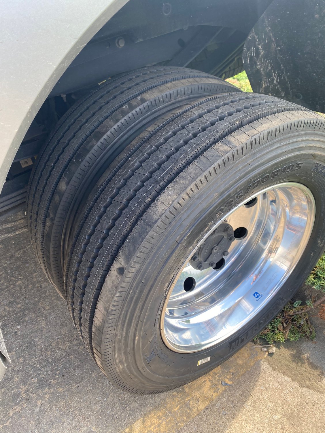

Originally Posted by slurugger
Could you share more specifics around the difference? Less 'float' than before? Doesn't catch seams / grooves like the contis, etc?
I was just really disappointed with how they wore at first. Within 1,000 miles the shoulders had noticeable wear then the tread blocks started wearing to different heights. I rotated them around 6k miles when I got Alcoa's and the rears I put up front did the same thing. Then around 10k miles I started losing chunks of rubber from the front and rear tires. Also once I got my Alcoas I took my Centramatics off the rear. I constantly had a vibration between 35-45 mph then again just over 50 and above 72. I tried balancing them on a friends balancer and noticed how out of round they were. I figured that was the bigger issue causing the vibration. Then when I had the commercial tire place instal the Michelins up front I had them look at the rears. They also told me balancing wouldn't help because they had too much runout. After leaving there with XZE's on the front I realized just how crummy the Conti's were. I could feel the road, I didn't have play or drift, no vibration at all and the truck tracked straight. So immediately I started thinking about the rears. Tomorrow it goes back in to get 4-XZE's on the rear. They aren't aggressive but honestly I don't see how the Conti hybrids would provide any better traction since the tread blocks are so close. I thought about the XDS2 for the drives but they are $104 more per tire and my main focus is having a smooth quiet ride pulling the camper. If 4wd won't get me unstuck I doubt having the hybrids would make any difference. I will update once I get my truck back tomorrow👍🏻
Oh and we have tried Continental tires in the past on my Wife's Rogue and also her current Odyssey. Never have we gotten more than 35k miles on them. I feel like their quality has tanked overall.

Got my rears done. Drives proper now.

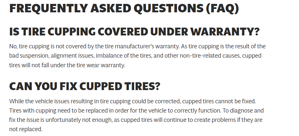

take a look at these three documents

I'm amazed how Continental could release a tire to the market with this kind of durability and Ford Motor Co. for putting these tires on their product.
