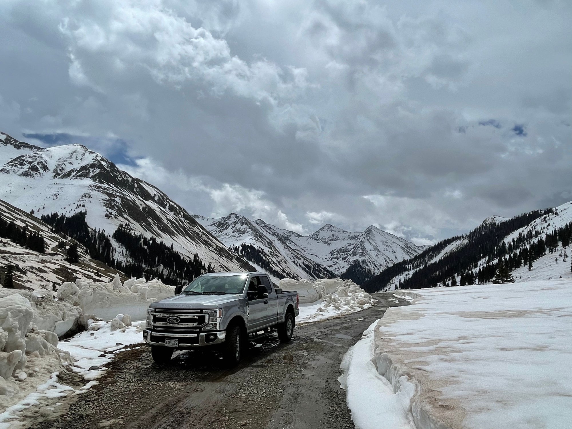

Originally Posted by RidgwaySD
Which is funny because you do not really see much of them anyway unless you crawl under the truck. There are manufacturer suggestions out there stating the 5100s are better if used off highway, which I do a lot, so yes, they look better and are recommended for my type of use by the manufacturer as well.
NICE PHOTO !!
