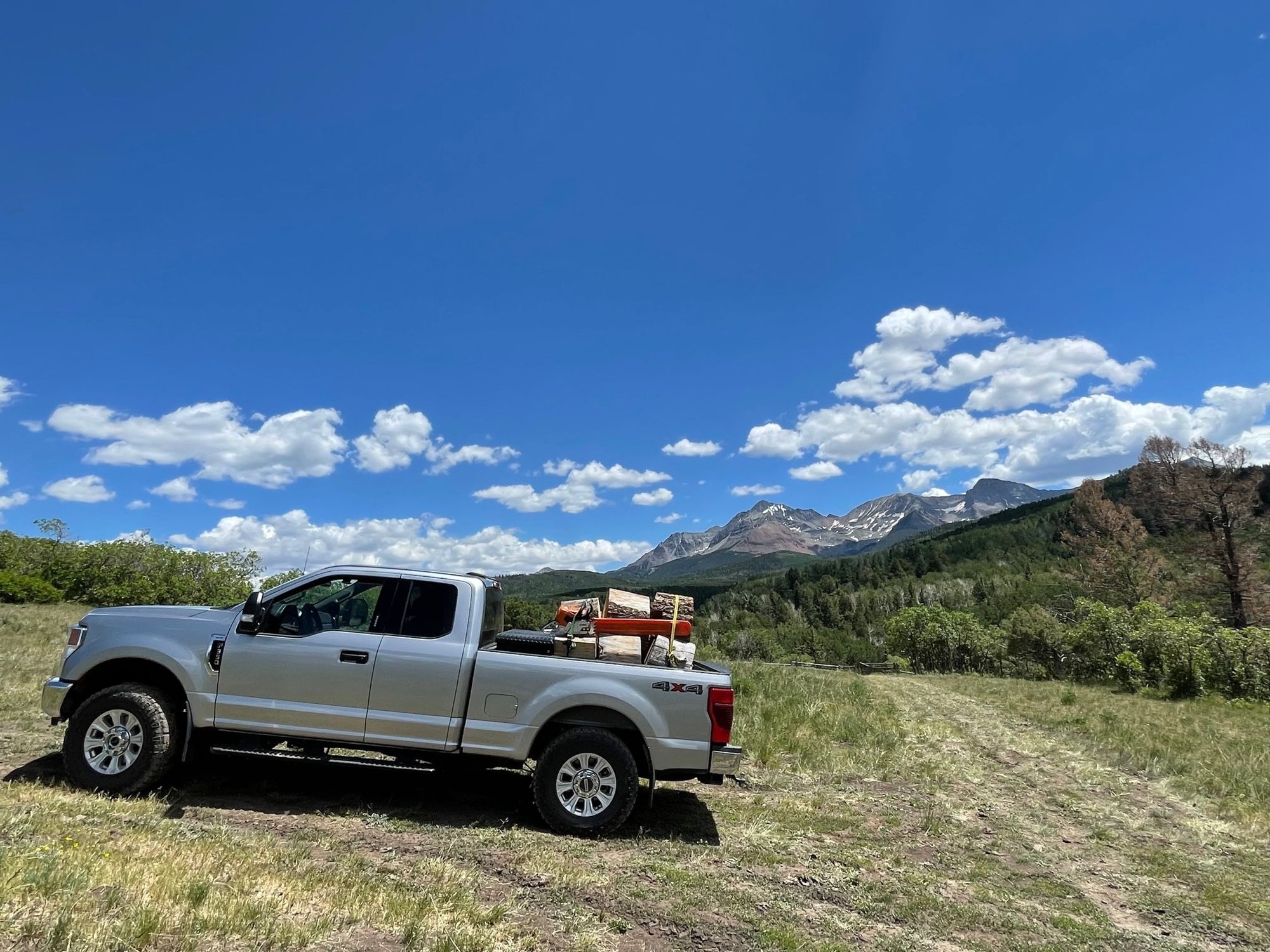

Originally Posted by ToMang07
That's pretty much what I expected... and between plowing and crappy roads I'm sure to get a good test on both ends, lol, I was just glad it tamed the rear end jounce going over bumps. (Unloaded)
Gratuitous wood hauling picture in the mountains...LOL Probably not more than 1000 lbs, not quite on the overloads but handling great on ranch roads, gravel roads and the highway...
