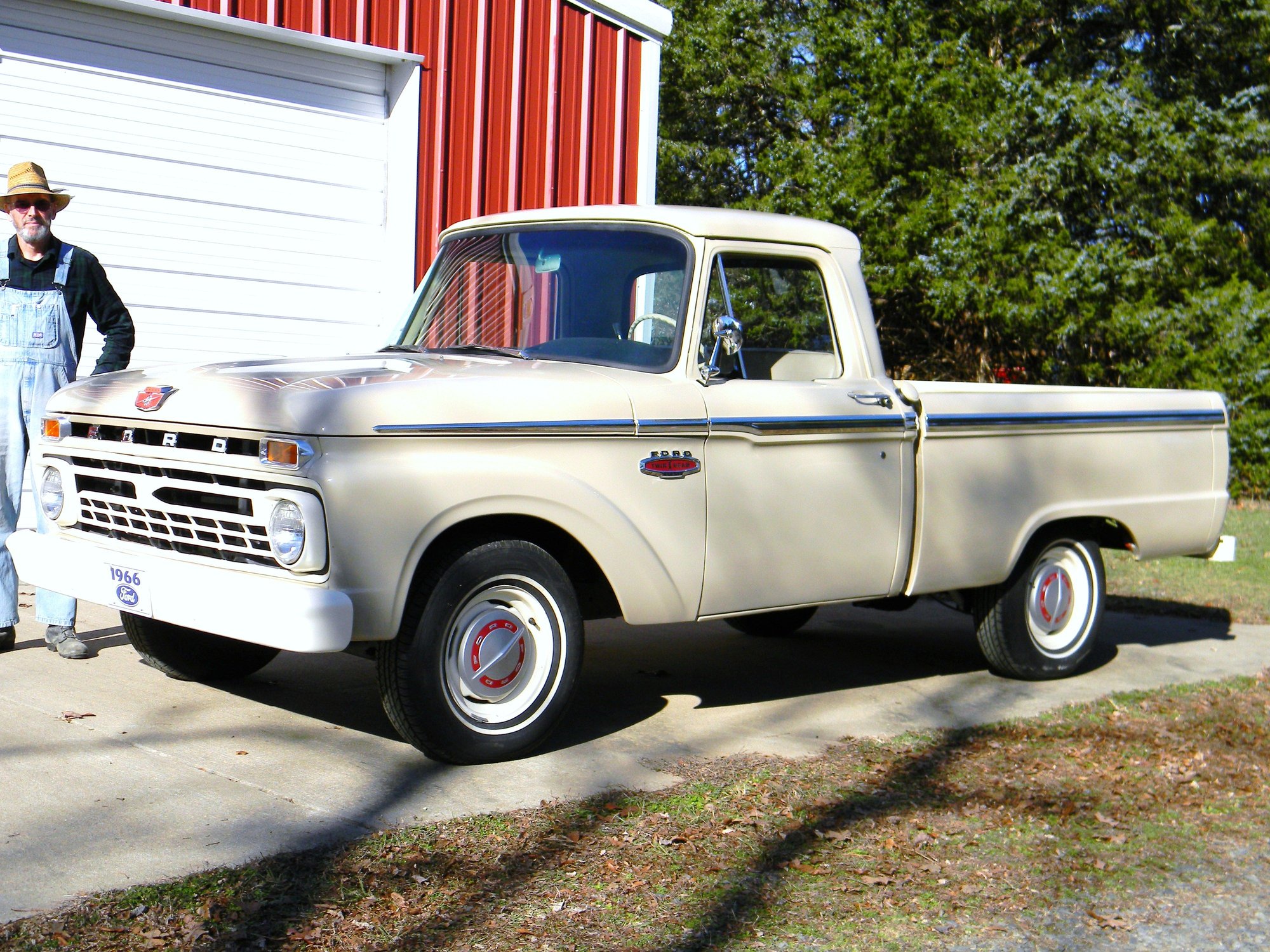

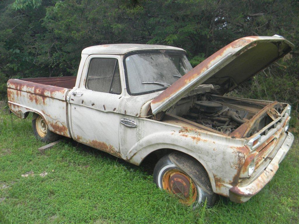

Well, it can be done. if you want it bad enough. finding a good right bed side will be hard. stripping everything down is the main thing. on this you need to blow it all apart and start from the beginning just as Mr Ford did. one piece at a time. This is what I started with. And finished with.
