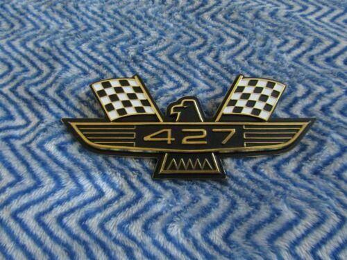

I was recently at a local machine shop dropping off a block and heads and having a chat with the owner. He had heard me pull up in the slick and asked about it, then proceeds to tell me about his 66 he picked up recently. Got a 427 in it he says, says he thinks it's original because it has the 427 badges on the fenders. We go take a look, it has badges (We don't need no stinking badges!) and an FE under the hood.
I didn't crawl under to look at the block but being that he owns an automotive machine shop, that does well, I figured he knew how to tell what motor it was (I hope). Didn't bother schooling him about Ford truck options, cause I didn't want to **** him off before he did my work. That's all.

Badges like this one?
