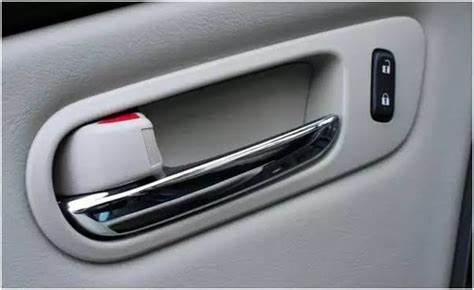

Here is just one solution that uses a cable, this one also incorporates the power locks...switch could be repurposed to be used for the power windows.
