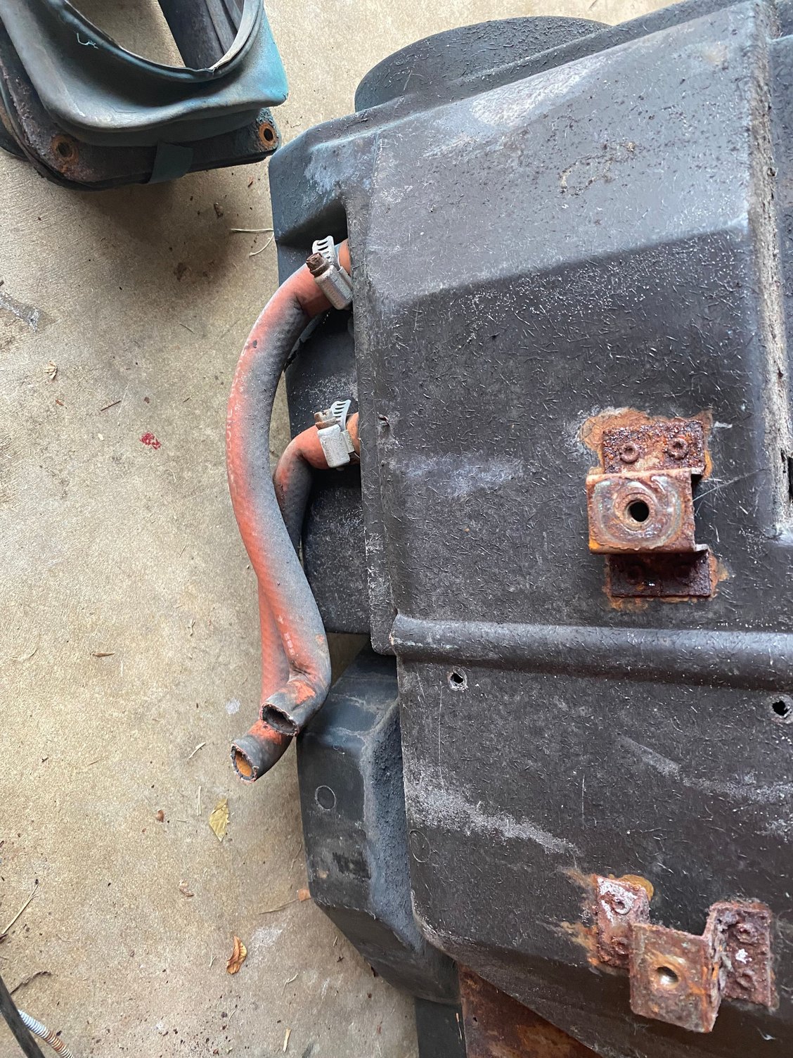

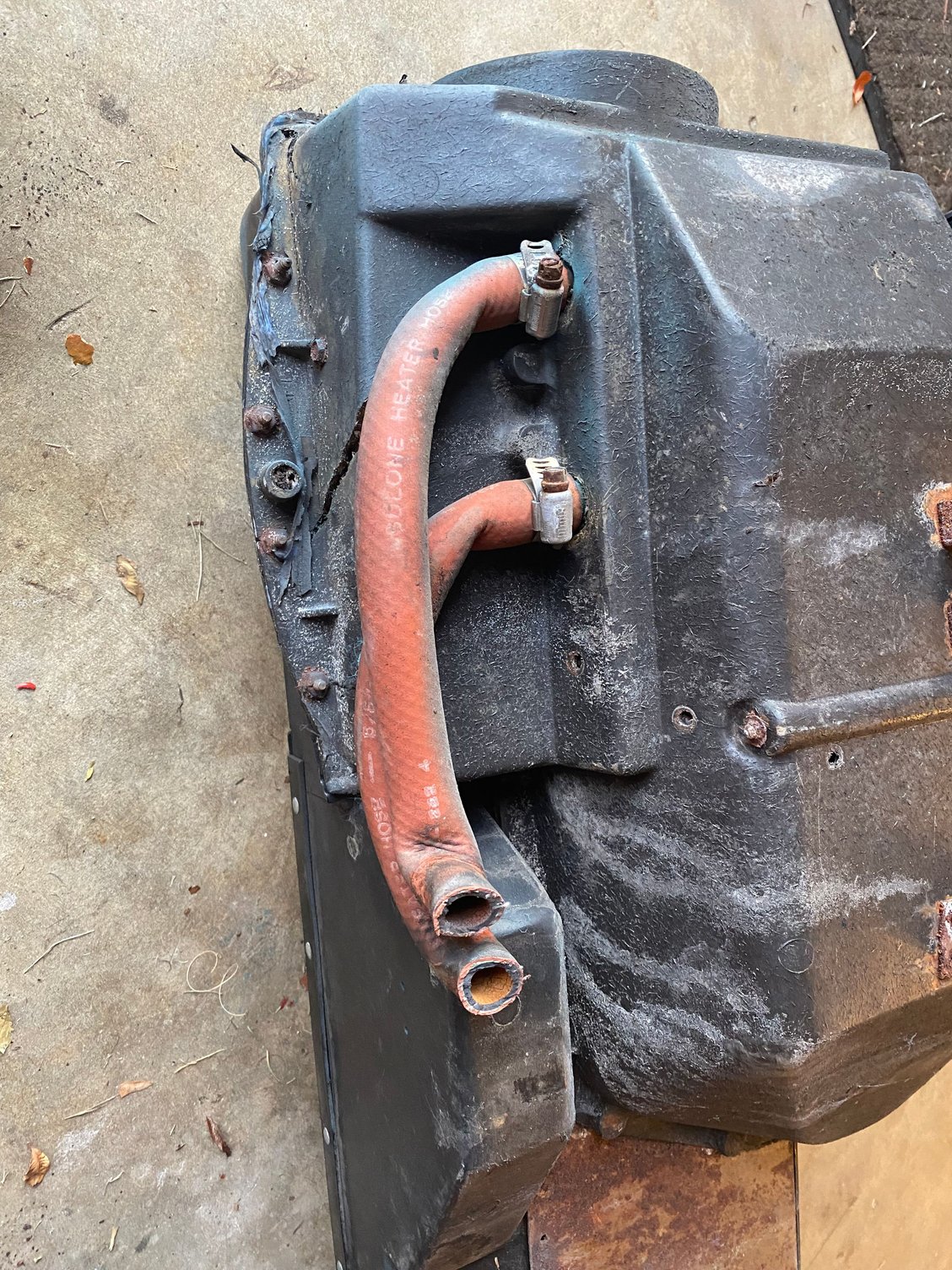

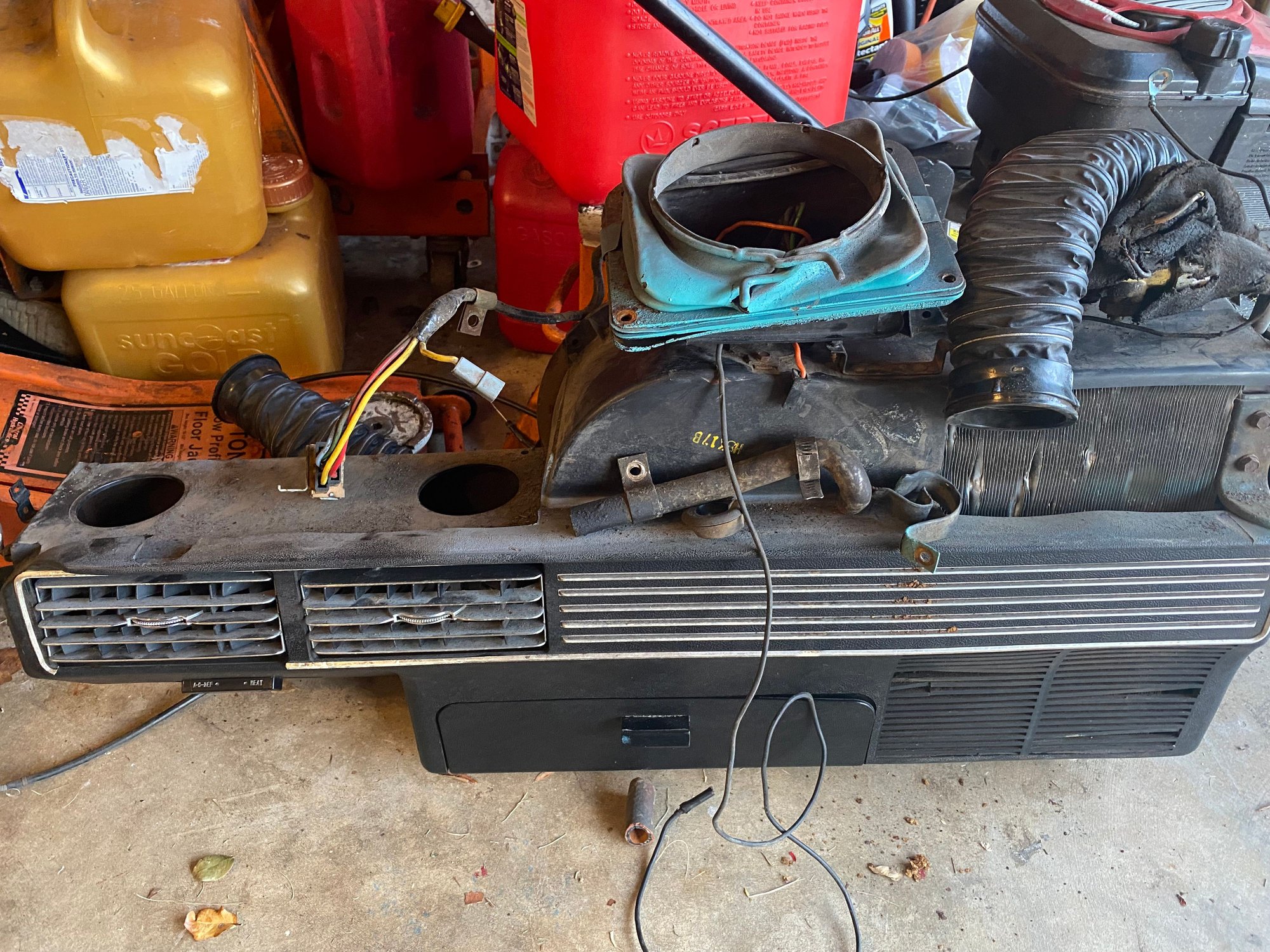

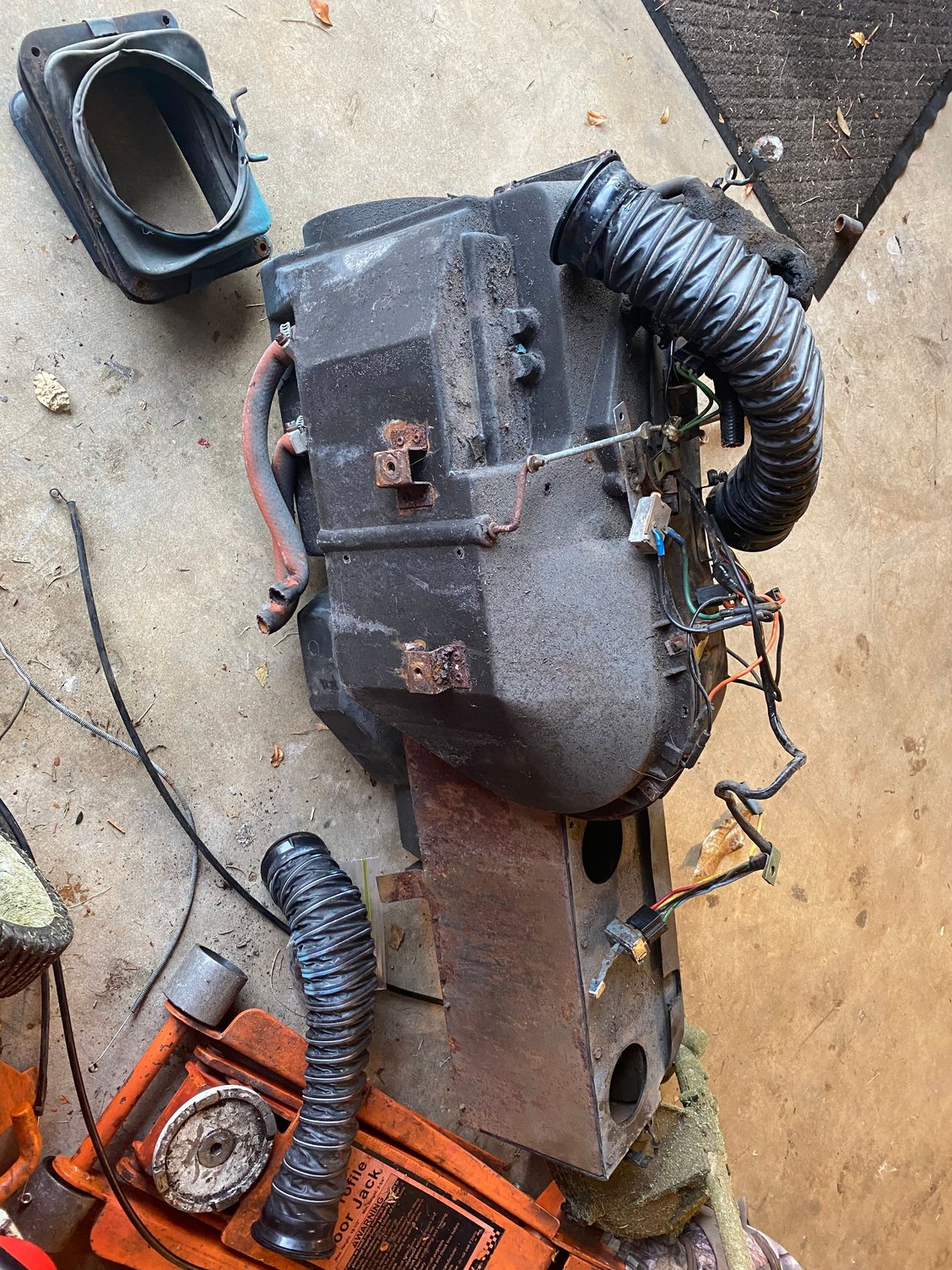

Removed my AC unit just a few days ago to install the Vintage Air replacement, so I thought I's snap a few shots of the back side. As Smoky correctly pointed out, the heater hoses, the firewall bolts, the underdash bolts and the AC hoses on top, will all prevent the unit from dropping. Add to that list the drain hose also.
Heater hoses
Firewall bolt holes
