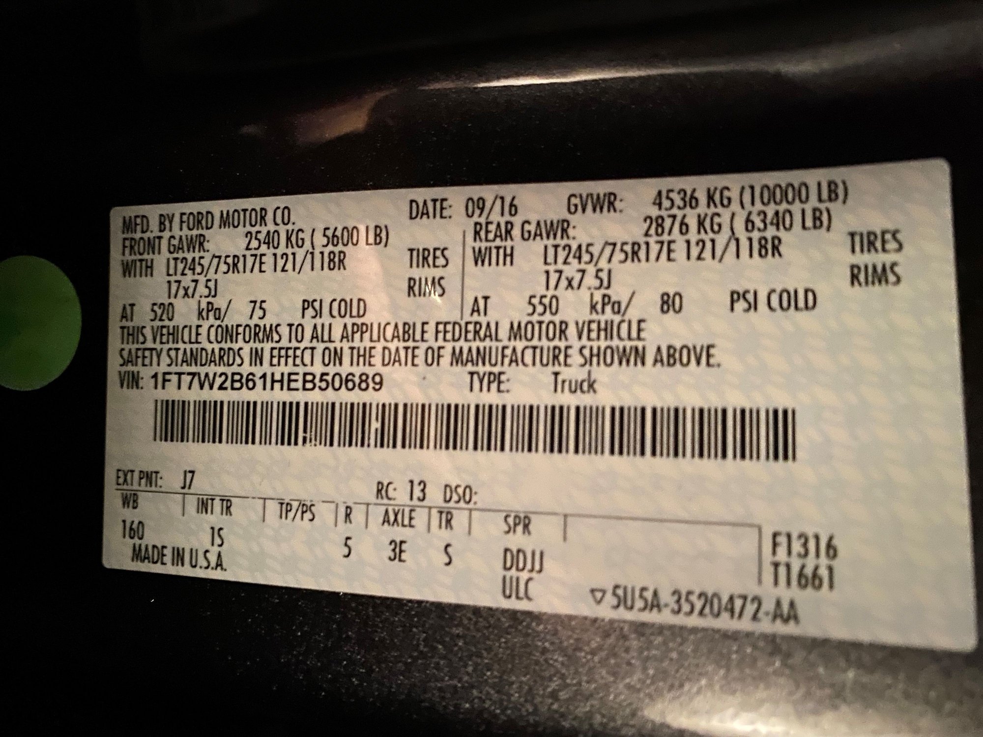

Question, my 2021 F-350 CCSB 7.3 ltr has a recommended tire pressure of 60 front, 80 rear. Does anyone know whether this recommendation is for a truck loaded to the max GVWR? Do any of you run pressures lower than recommended and if so, what do you set them at?

Yes, those tire pressures are based off of max for that truck configuration. Make it a 250, same exact tires, you'll see 60 front, 65 rear on sticker. Mine being a 250, I aim for around 55 all around. Same exact Michelins that would be on a 350 with 20" wheels.
You could do the same, but being a 350 your TPMS light will come on unless you lower the threshold.

Thats for the max gawr in your configuration.
You can lower tpms settings just make sure you can get up to around 80, + because of heat variance, without the light coming on. Obviously need to air back up when hauling.

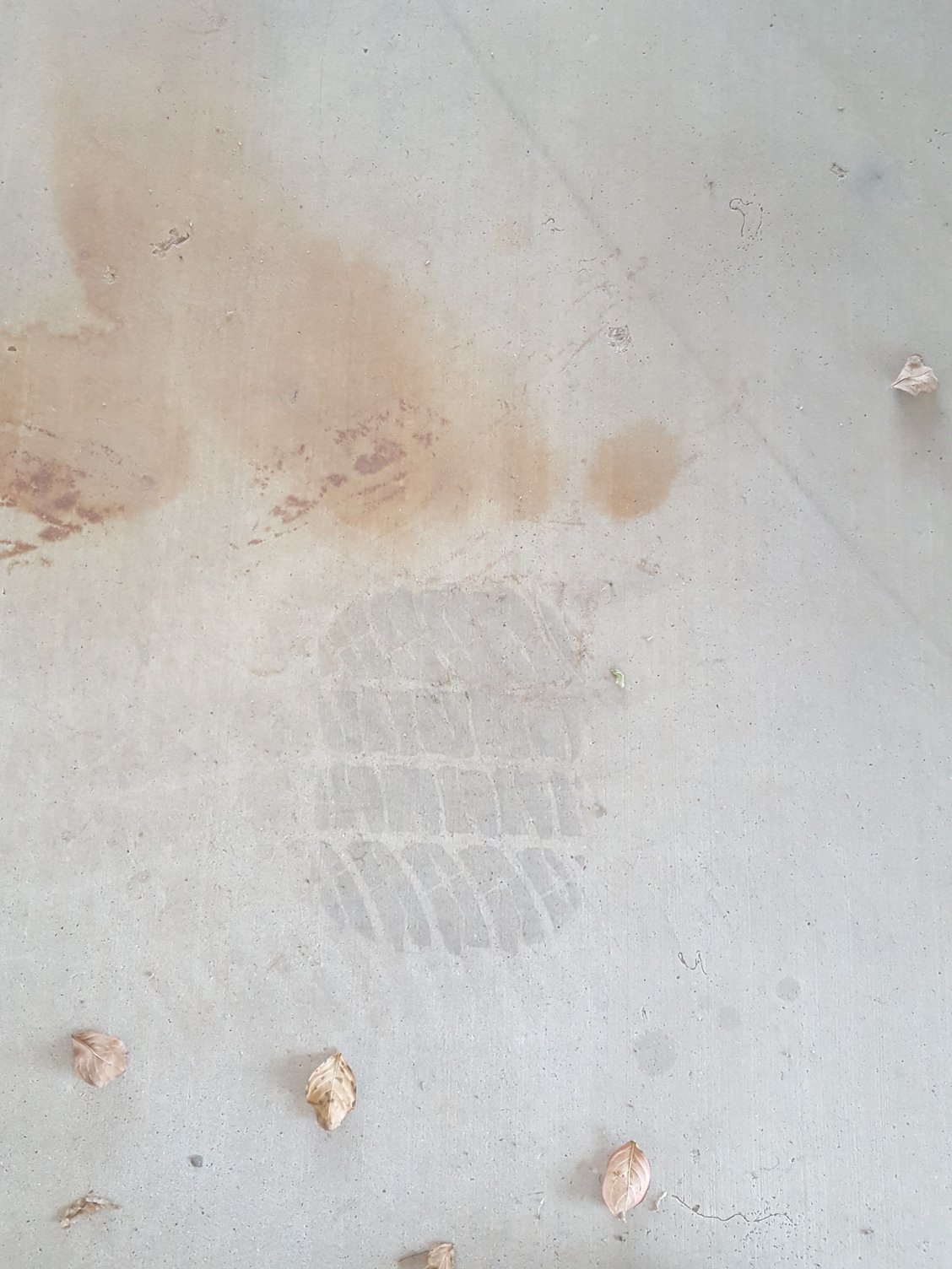

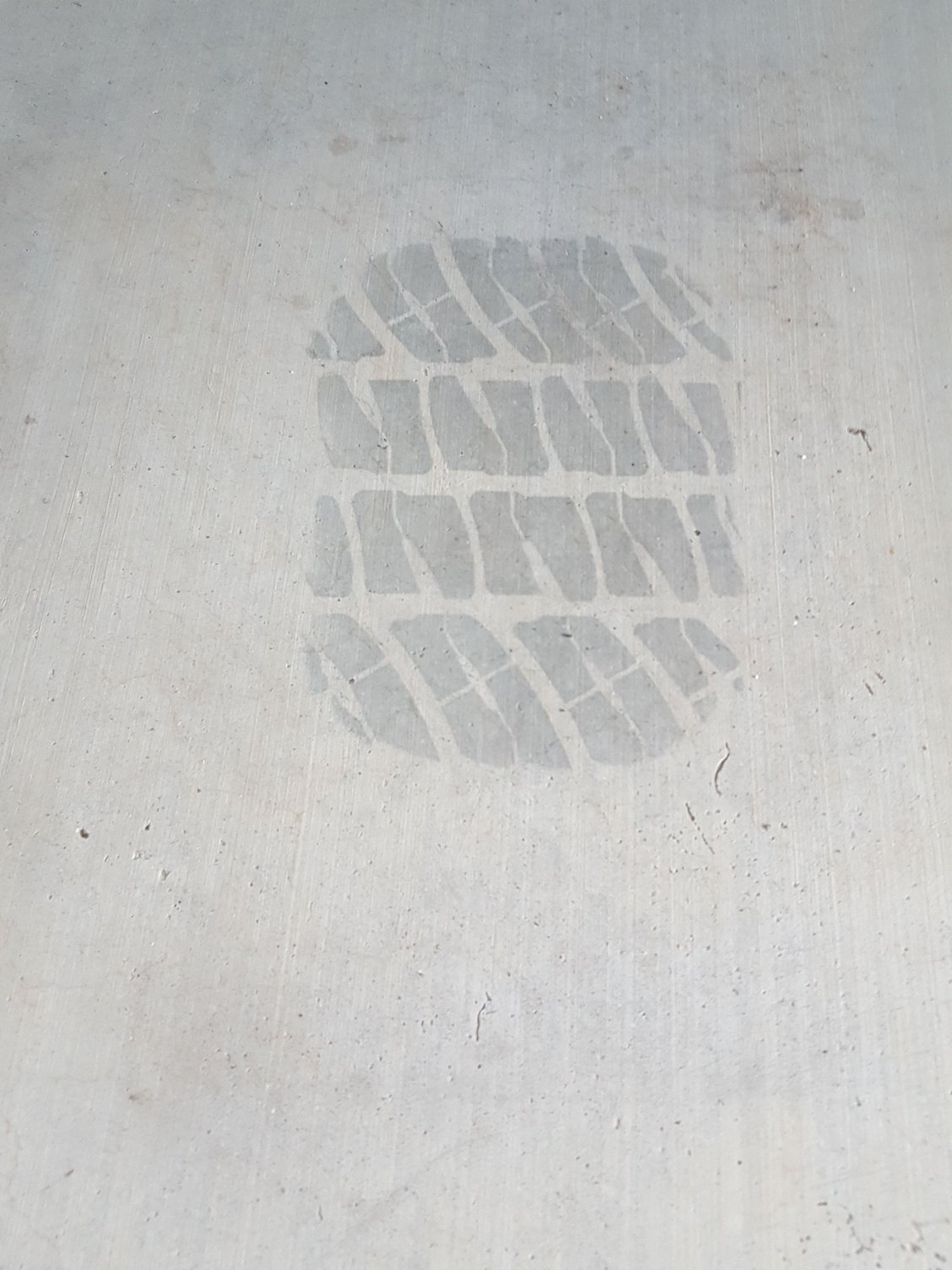

Originally Posted by robert sloane
i run 65 up front and 60 out back empty when i have the hauler trailer in tow i bump the rears back up to 65
i tried 60 up front and it felt squishy, even though the sticker wants that
i tried 65 out back and it beat me to death empty
tried 55 and it wore the center to a furry bit after 75 miles
so i run 60 and it seems to be the fit for my vehicle
i also used the steel ruler and tried to adjust pressure so the tire print is even across the tread with just a slight edge up on the outer tread pattern
THIS!!!
Not only can you run lower pressures... but you should.
Too much pressure will wear your tires out in the center of the tread.
Too little, the outsides of the thread.
Too much pressure empty and youll feel the tires bouncing. In the rain youll slide easier.
I also run lower pressure in the rears when empty as theres little weight there.
I run 65 front and 60 rear. No need to change the TPMS for that and my tires print across the tread in the dust on my shop floor.
Thats the 20" Michelins.
