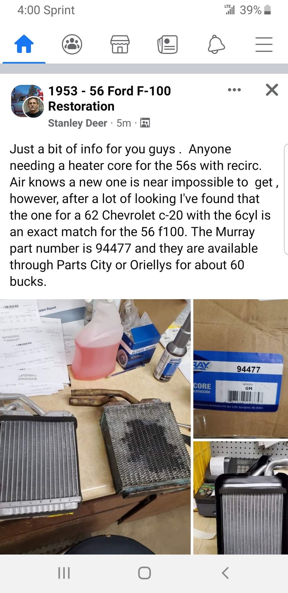

My first recommendation would be to find someone with a good used one that has been pressure tested if possible
Second would be to find a radiator to repair yours if possible
I saw this "possibility" on Facebook
I dont know if this works or not. Just thought it would be good to hold onto.
