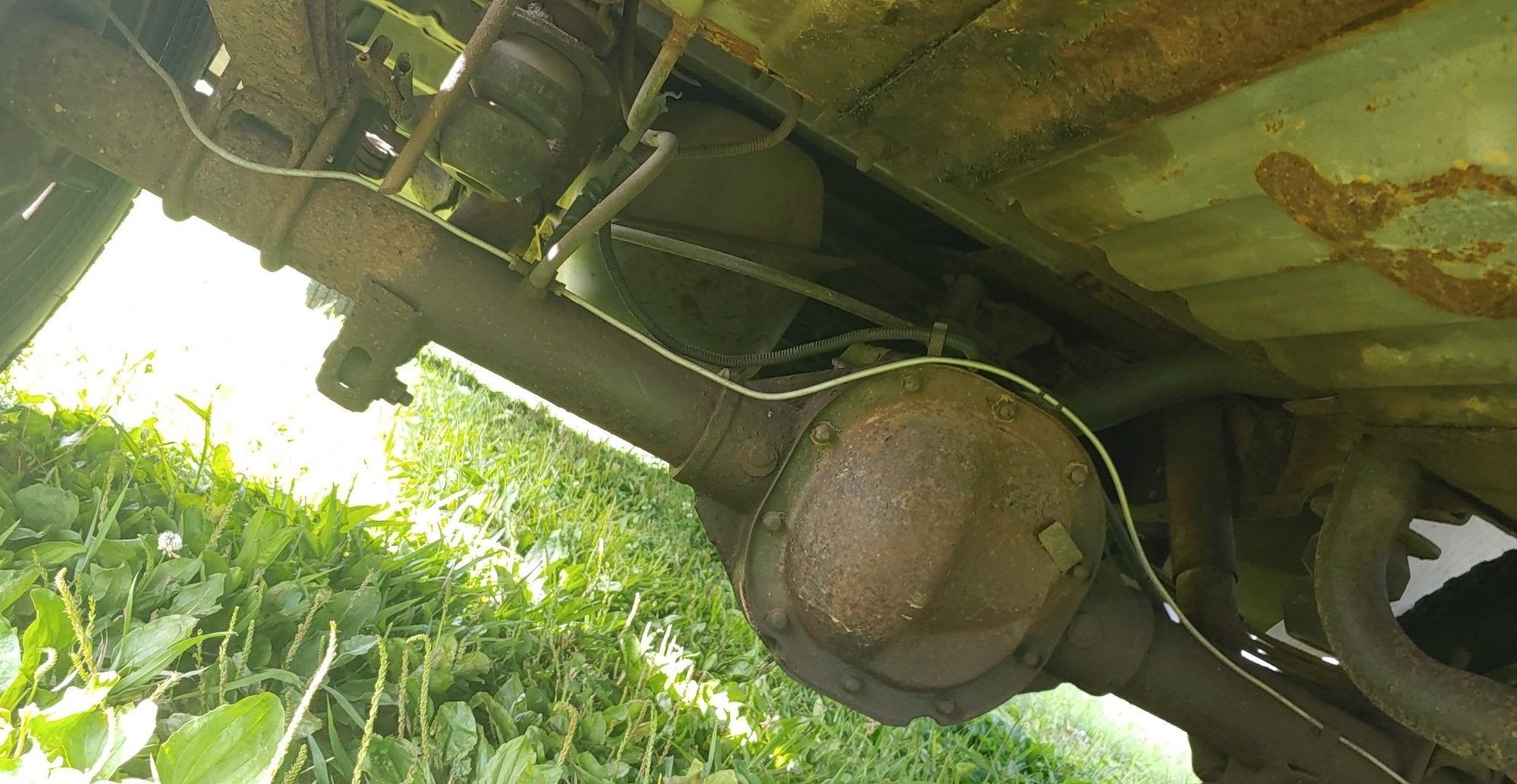

If you have a rear axle tag you can tell if its limited (from factory) which is a clutch type If Im to be believed, which can wear out. But 3.08 ford 8.8 rear sounds about what you probably have
This is a 96 but this is, presumably, the factory location of my tag and its got 4-5 letters, 8.8 or maybe 8 8, 3 08, and pretty much that.. 3.08 and 8.8 and (julian date?) being what I get from that. It would have an extra letter iirc to be limited slip, but I dont know about your year.
Also I would question your parking brake cables and brakes since a little dragging isnt unheard of. My truck had a kinked cable on one side and that came from not being in the retainers /guides and that applied the brake on one side. I cut them to get home but it was surprisingly driveable however wet grass on flat ground was enough to one wheel peel, so something to look at
3 08 88 means an 8.8 with 3.08 gears open diff.
3L08 88 means an 8.8 with 3.08 limited slip. My tag has been long gone but I am fairly confident I have an open diff, baring any broken parts I am not aware of yet, 8.8 with 3.08 gears. Thanks for the help everyone.

found my tag but you seem to have a grip on the meaning, plus you dont have a tag. Have you verified no brake issues?
