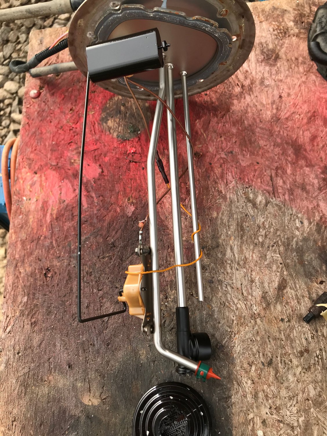

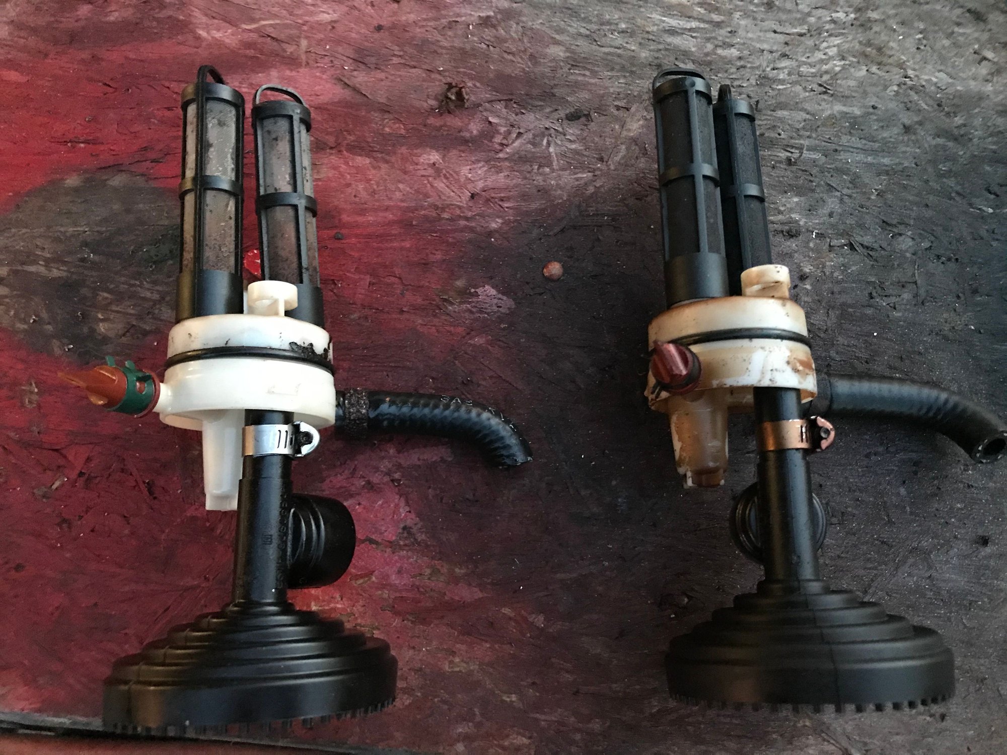

The idea that FRx or RR is necessary to improve longevity, reliability or ANYTHING else is extremely flawed.
Of course, a lot of folks still think the factory fuel lines ‘suck air’ too.
I agree with Y2KW57 except I like moving the non-serviceable filters in the tank to the frame.
Did this to (2) trucks yesterday. One has 94k miles and the other 220k miles. These trucks fall into the <20% I find with the pickup foot intact....
https://www.ford-trucks.com/forums/1...poon-mods.html

Didn’t your truck come from the factory with a ‘SSJ-style in-tank mod’ situation? (No mixing chamber/filters) Except I get rid of the failure-inevitable umbrella.
