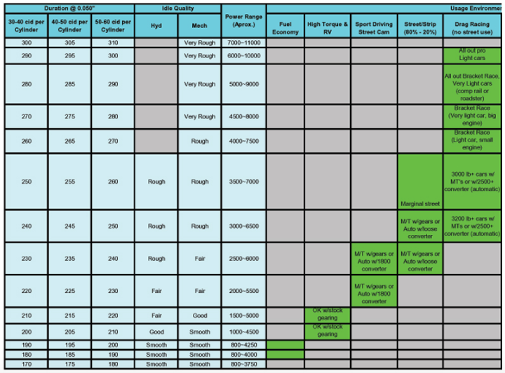

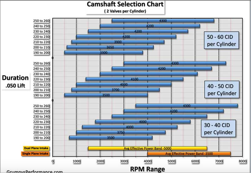

It would make more Torque & HP. Peak torque would be at a lower Rpm if using the same cam. The longer stroke has more cylinder vacuum for filling to get you the extra power.
Richard Holdener on Youtube did a big head test. First using a 302 cuin then a 331cuin. At 8:15 in the video he talks about just adding stroke using the stock E7 heads and why it made more power.
At 6:00 he shows the 392 with the stock heads. Also note that with each increase in Cuin he used a bigger camshafts with more duration. What all this is showing is how more Cuin will draw on the same heads.
I have tossed around the idea of building a stroker and came across a couple of graphs on Camshaft's VS Cuin. In the chart you can see if using the same cam duration it moves the power band downward.
You should also take a look at these....

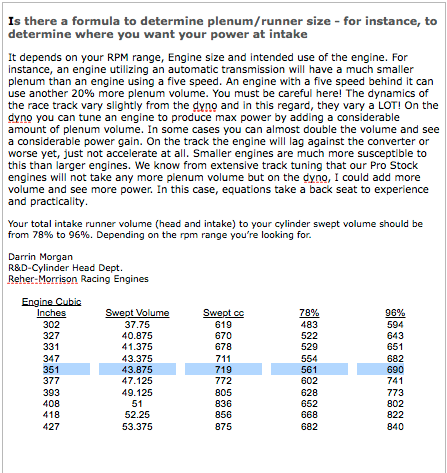

There is not a lot of info out there for runner length but I did come across this a while ago....

Total intake runner volume (head and intake) to your cylinder swept volume should be
from 78% to 96%.
Back to the measuring devices and calculator, thank you, perfect!
