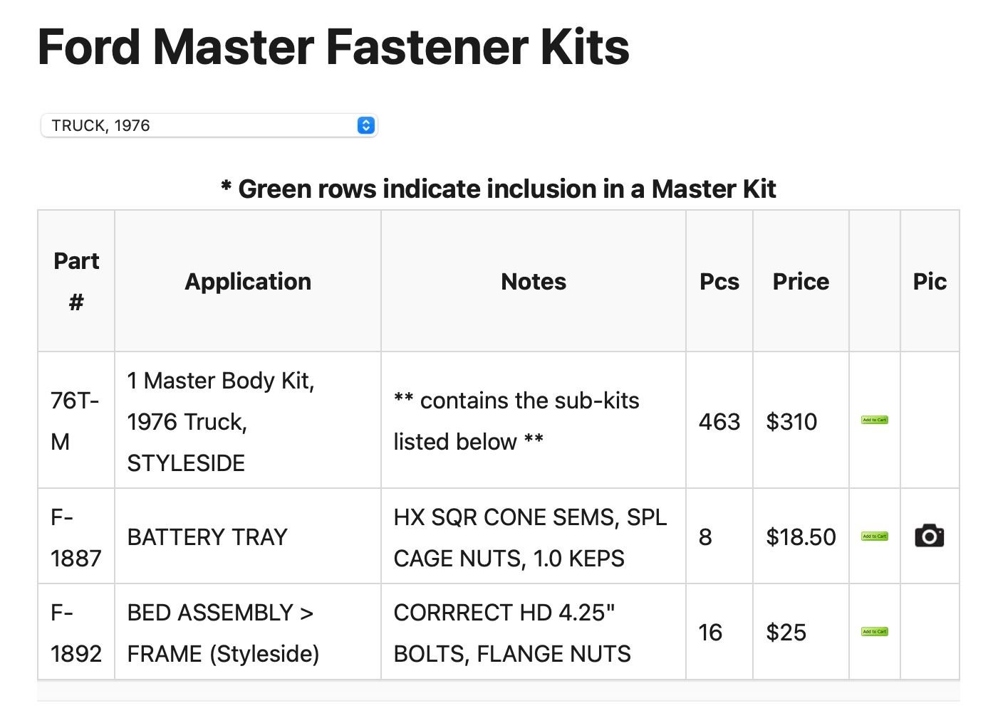

Here's what I found there:
You get 463 fasteners for $310, an average of $0.67 each. Might be the way to go for some folks.

After buying nuts, bolts and clip nuts from several sources I have concluded that AMK Products has the more complete / authentic hardware and offers them in modular kits such as all the fasteners you need for two fenders in one kit. Indeed other vendors sell their stuff at a slight markup. Their high res images resolve many of the questions you might have about each kit (e.g. how many of each item do you get) except where they go on the vehicle. For example: Here is a page that details all of the kits for our trucks. Take a look at the FENDER APRONS and FENDERS kits for good examples. They also offer bulk purchases. Their web site has an excellent imaging and lookup facility to help you. Online shipping is $10 and there is a $30 min purchase so best get all that you need in one purchase.
Of course you can always purchase their Master kits such as the master body kit for $310.
