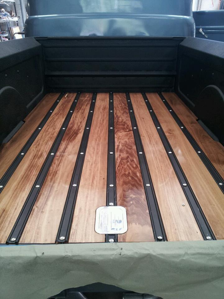

We have a 1950 F1 & we did relocate the Tank out back under the bed. It's a good project and
well worth doing. Not sure where you are in Texas but if you are near Austin - welcome to come by to see
our set up. We used a 20 gallon 1970 Mustang Tank from Rock Auto for around $120 plus the sender unit cost.
We followed Jniolin's really nice write up on the installation. Some thoughts:
o You will have to relocate one of the braces under the bed and you will lose
the spare tire space under there.
o It may make running exhaust out the back more difficult. It can be done it's just harder.
o Think through your sending Unit to Gauge set up Before you do this project. We used the '70 fuel sender set up
for the fuel pick up line & then we soldered on a universal sending unit to talk to our after market gas gauge.
o Think through your Tank Venting. We used a vented gas cap & thought that's all we'd need. Nope.
We had to add a second Rollover vent to adequately vent our tank in the Texas heat. (Much easier to do ahead of time).
o Having the fuel fill in the bed - Picture my son Zack lifting up the big heavy couch we were moving in the bed so I could fill the tank.
Fill it up before you start moving stuff.
We went really slow & it took us a weekend to do this project.
