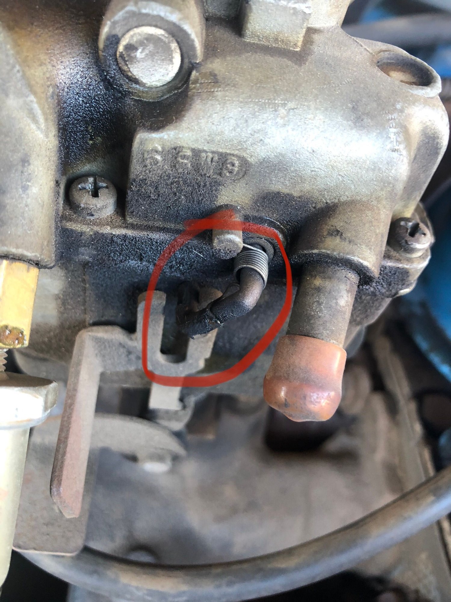

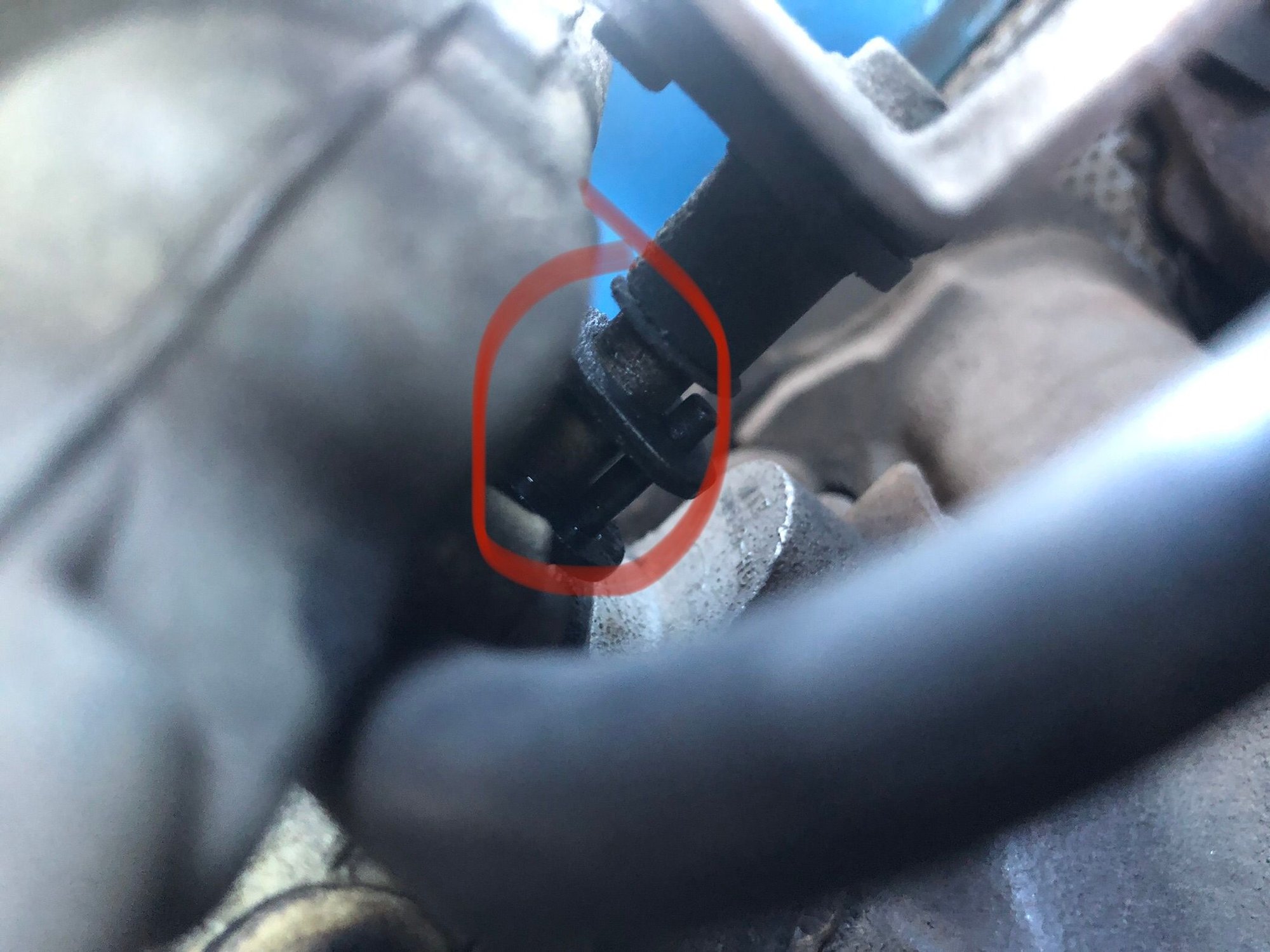

Quick question for you guys. 1978 with the inline 6. After fixing a couple vacuum leaks, I am definitely running rich. Smoke on a cold start, and it’s almost like my carb floods itself unless I keep the RPMs a little higher until it warms up a little. All those issues go away but I can still smell that I’m running rich. Yesterday I got the truck warmed up, backed in the mixture screw until she wanted to die, then backed it off 1.5 turns. Upon doing this, I sprung a couple fuel leaks. I circled where it was coming from. All my screws are tight and it’s not coming from the carb/manifold gasket. I already have a new carb that I’m picking up after work. When I tune it with a vacuum gauge, do I put it in the port where the vacuum line from my brake booster connects?

You might be right on the carb being done for but .....
The first picture is that the throttle shaft at the body that was leaking gas?
Before you pull it off get it up to temp and at idle using carb clean spray that area and see if the idle speed changes.
If it dose then yes the carb is done for. There is wear at the shaft & body causing a vacuum leak and this can not be fixed with a rebuild kit we can get.
The carb would need to be pulled apart the throttle blades pulled out (if not put back right can cause issues) and then pull the shaft.
Shaft would need to be turned down and the body bored and bushings fitted before being put back together.
Again not something most of us can do.
Dave ----
Yessir that’s where one of the leaks was coming from. She was up to temp, all the screws were tightened, and there was a steady drip coming out of there. My next question is the studs to mount the carb to the intake manifold. Realized one was snapped off at the top, but enough to still barely thread a nut on. I’m going to replace those, but nobody has them in stock so I need to wait. Everything I looked up said 5/16 but these are definitely 3/8. Does that sound accurate?
