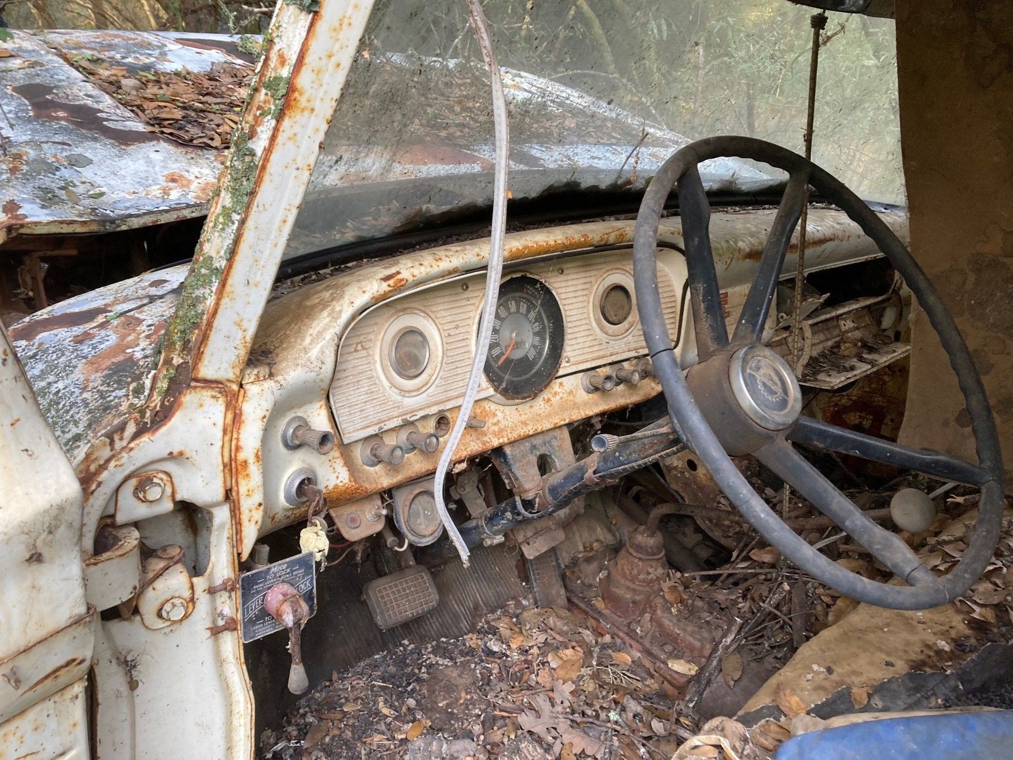

Can anyone help me decode this Ford data plate? I found this F-350 on my new property and am thinking of getting it running. I think from the grill it's 1964, but not sure of that either. Any help is appreciated.

Decode Your '63-'64 Ford Truck VIN Tag - FORDification.info - The '61-'66 Ford Pickup Resource

OK, after more research I think I have it figured out:
Conventional Series 350, Light Duty, 292 MD V8 - 2V - Dual, Built in April 1964 in San Jose, CA 132M F350 681 F23 132" Wheelbase, Wimbleton White (1964), Model F-350, Conventional Cab, Black Vinal Interior 10000 135 3800 71 10,000 GVW, 135 H.P. @ 3800 RPM
Not sure it's worth putting money into, but its a cool old truck with a concrete pumper installed.
