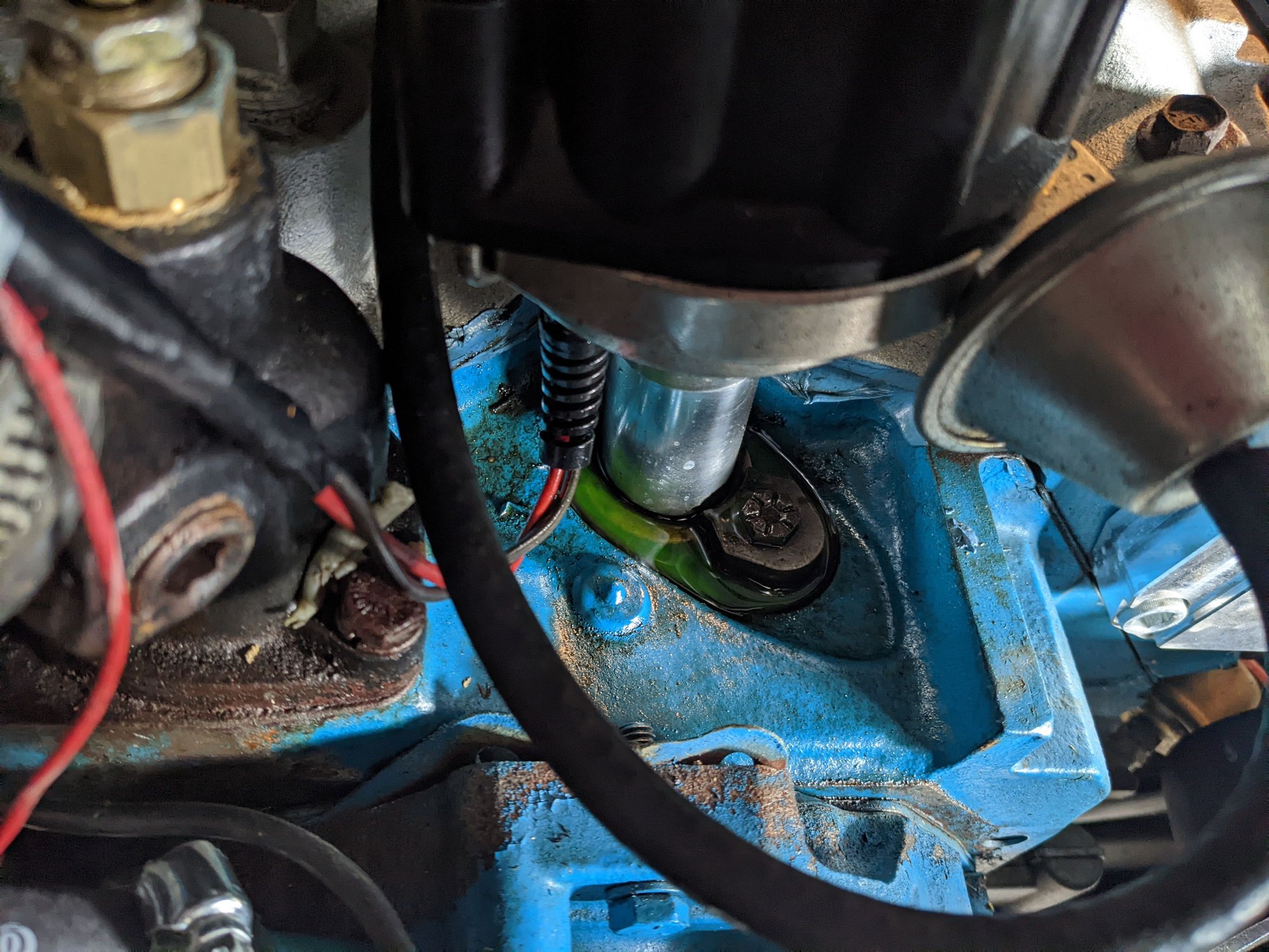

Ok, I have a 40+ year old truck, and I know they all leak. I recently moved my truck and now it has started doing something new. A few drops here or there are normal to me. I noticed a puddle (about a 2' circle) a week after I moved the moved truck. I feel like it was water/anti-freeze and not oil. When I went to check, I found this:
I tried to soak it up with a rag, and it seemed like it kept filling up out of the distributor. I believe that should be impossible. Any idea on how anti-freeze is getting there? I have already checked the heater hoses and the top radiator hose.
Any help would be appreciated.

Looks like your thermostat housing is leaking.

Looks like the thermostat housing gasket is bad.

Could also be coming from the intake manifold?
You want to clean the area as much as possible to see if you can determine where moisture trail really begins.

The thermostat housing might be eaten through, or the gasket, the upper part where the hose fastens on, won't be the intake, they are dry on that engine.

Not coming from intake manifold. 351M / 400 don't have coolant crossover in intake manifold. It's most likely what 440 said, from the thermostat housing. Mine's done that before.

One you fix this change your oil. I saw a 400 that had standing water leak down past the distributor neck into the crankcase.

You're right; it didn't come from the distributor. You'll have to continue soaking it up and try to trace it back to its origin. Then you'll know what needs fixing. If the engine has no seal at the base of the distributor, the coolant could migrate into the engine oil as suggested.

Agree with others on T-stat housing leak. Looks like it may be an over torqued bolt or failed lock washer on bolt.
