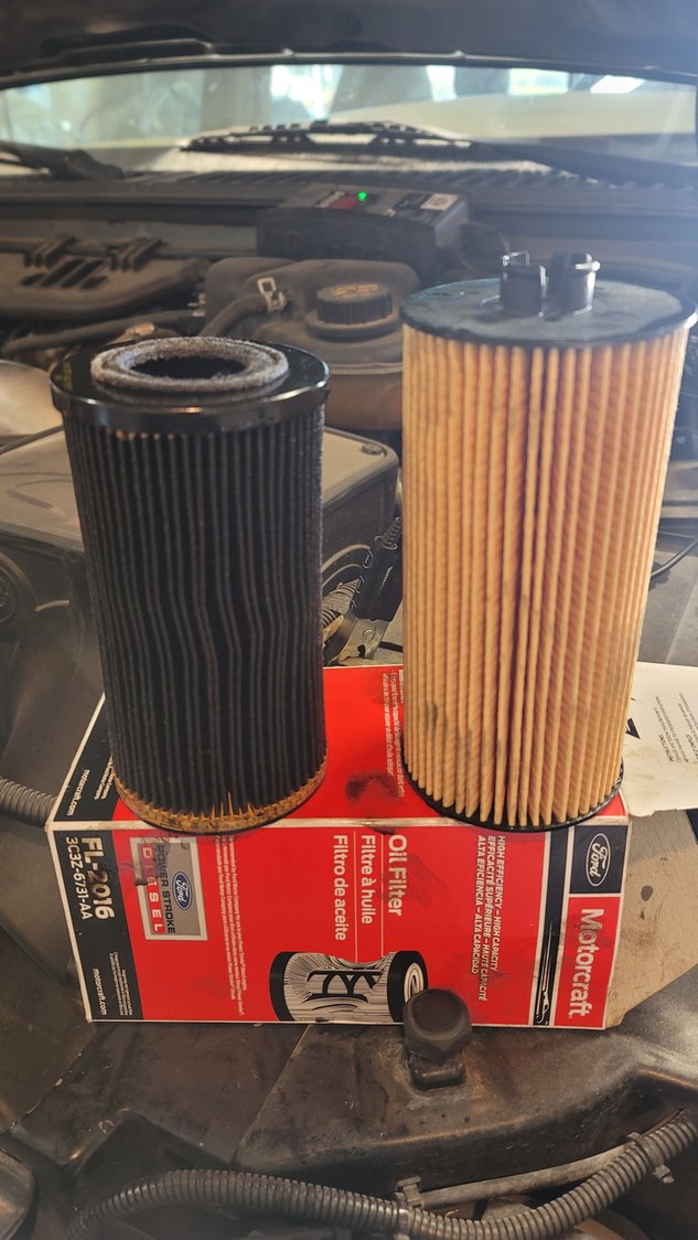

Finally had to do my first oil change since buying my truck. Only to discover that the PO used aftermarket crap. So then had to source the proper cap....
While wrenching on the oil cap, I realized that my charge pipe boot is trashed. Time to replace them all...

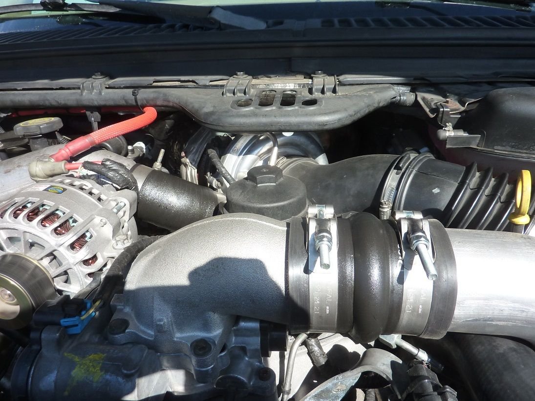

If you do still have the plastic charge tube, a good time to replace with the unit pictured. It comes with the boots. The boots for the hot side run ~$45 each through Rock Auto. Those are Gates part numbers 26220 and 26221. I'm sure you can find other options out there, some for more, some for less.

I got the riff raff for the hot side. OEM on cold side (swapped the plastic to metal pipe plus oem boots). Happy with both. The riff raff boots are stout for sure. And they have the bead for the pipe. I noticed other brands did not have the bead on the boot to align with the pipe.
