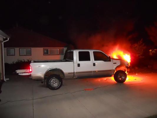

Positive result for spark at terminal:
Is that a gasser?
I have had enough Diesel Fuel and oil in the valley for many years that you could swim in it. If it did not catch on fire after three years..... I stopped worrying about the 'heat' and/or 'spark'.... Yes, I finally tracked down and plugged all the leaks and cleaned it all up and out.
