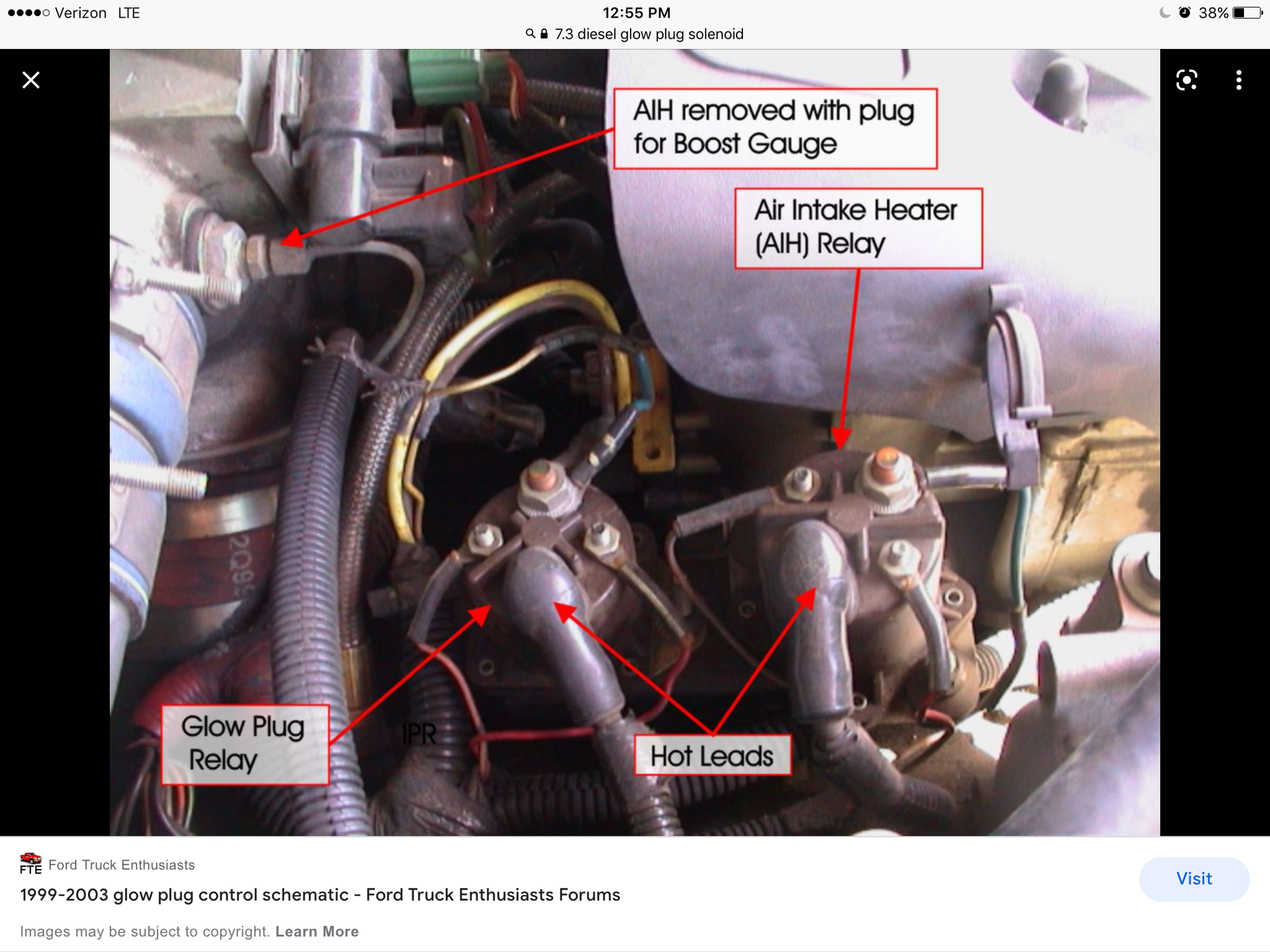

An easy check is to "jump" the glow plug solenoid. Use a screwdriver to connect the 2 terminals on the solenoid. Do this for 15-20 seconds with the key on. Then jump in the truck quickly and fire it up. If this helps it start easier then you know your solenoid is bad. If you replace the solenoid buy a good one. No parts store off brand. Buy a stancor, trombetta or motorcraft.
ill see if i can post a photo if you need.

Dont bother doing anything w the air intake heater. You are just connecting the two large terminals on the glow plug relay.

alright. Looks simple enough. high likelyhood im about to have to crack the valve covers, myself, finally..... 100% honesty, ive avoided it, because, 1.... a touch intimidated, and 2..... im concerned i may start my very own whirlpool of mods, fixes, and upgrades under there.... 😬

We can help you test the GPR (glow plug relay) and glow plugs without going under the valve covers if that is what you would like to do.
Your truck should be able to start well below 0° if the glow plug system is up to the task. Worn injectors will exacerbate the glow plug system failing, but you can usually get around that unless they are gone.
The links below were taken from the 7.3L PSD Tech Folder on the main page of this sub-forum.
Glow Plugs, Glow Plug Relay, Glow Plug Control ModuleThese should get you started testing and once you know what the failure mode is, we can help you get it back into working order.
