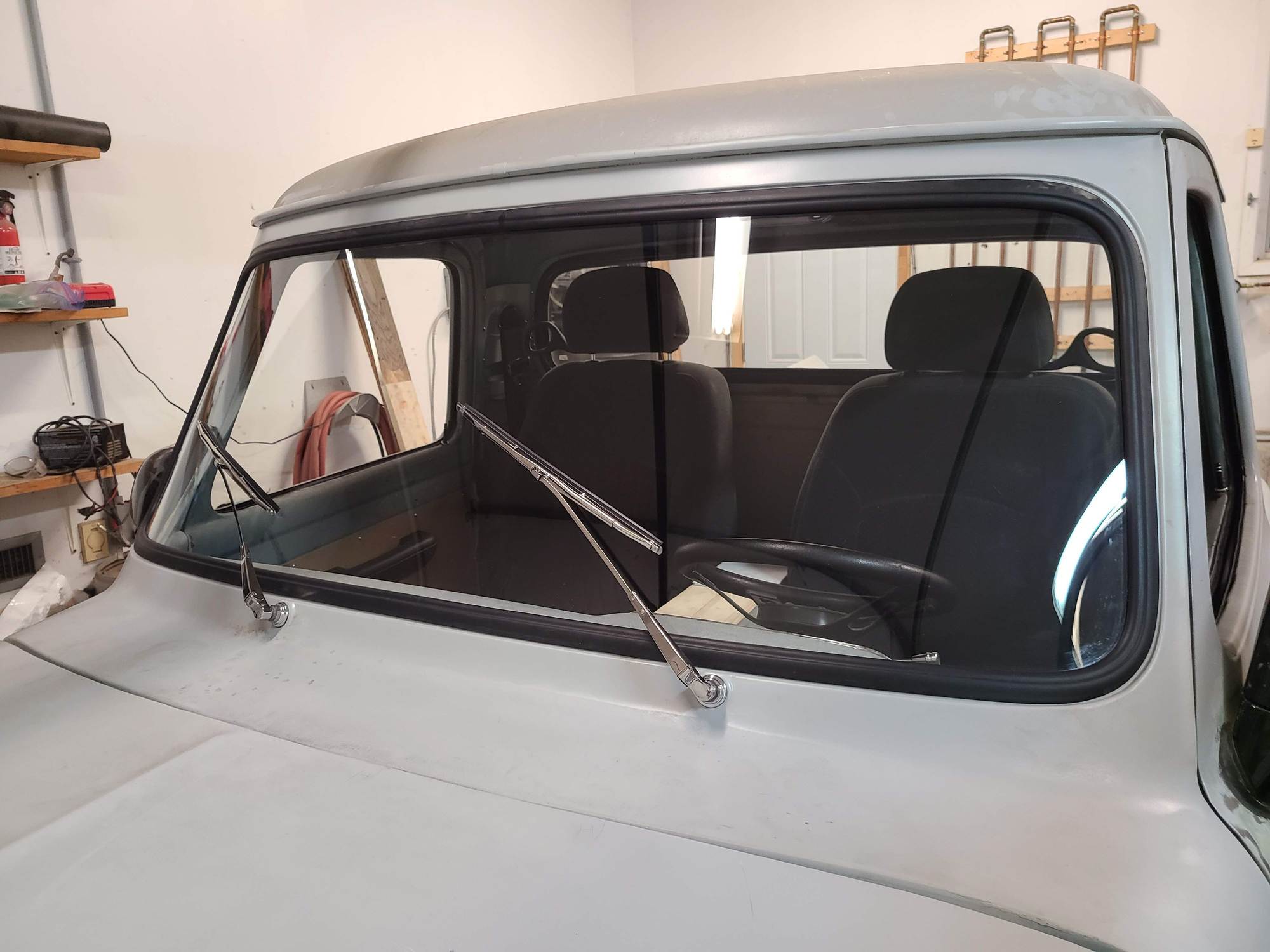

My wipers don't sit horizontal. Is this normal? When I turn them on, they go down to horizontal, go up and across, back to horizontal, etc. But when I turn them off they part like the picture. If I put them on horizontal in the park position they go down below the gasket, them up. I am using a new 12 volt motor and the existing bars.

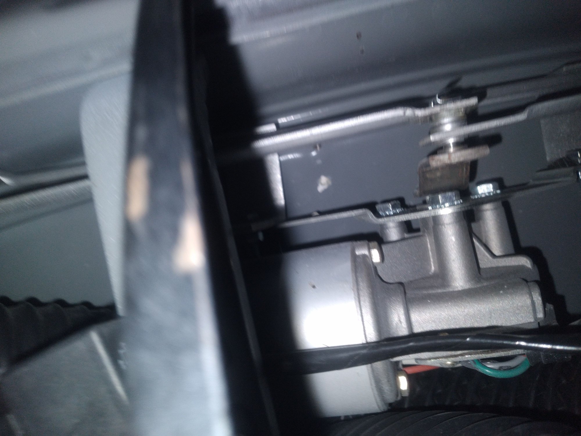

I just took a look under the dash at my motor & linkage. The arm on the motor is pointing straight down in the parked position. If you look at effie's pictures, the arm is pointing to the driver's side. So that is probably the reason for the problem.
It looks like I can get to the nut that holds the arm on without removing the whole assembly. I hope.
It sometimes looks easier than it really is.
I probably won't be able to get to it until next weekend though. I'll let you know how it goes.
Arm pointing straight down instead of to the driver's side.

I was able to remove and change the position of the wiper motor arm without having to pull the whole assy out. So happy about that. I moved the arm so it points to the driver's side instead of straight down. And now the wipers work like they're supposed to.
