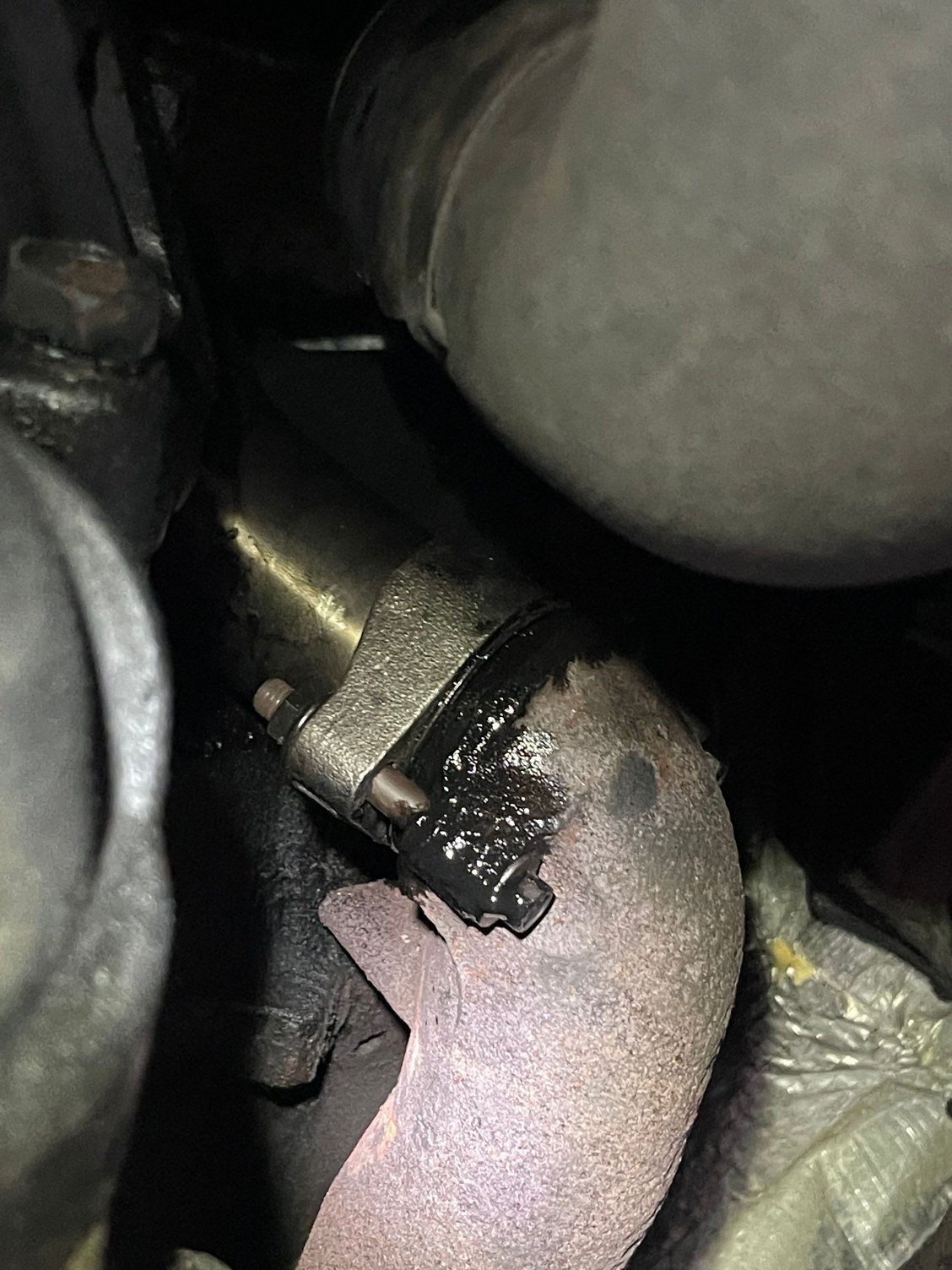

Oil temporarily leaking out of the manifold is somewhat normal after an injector swap. If it continues, you have an issue.

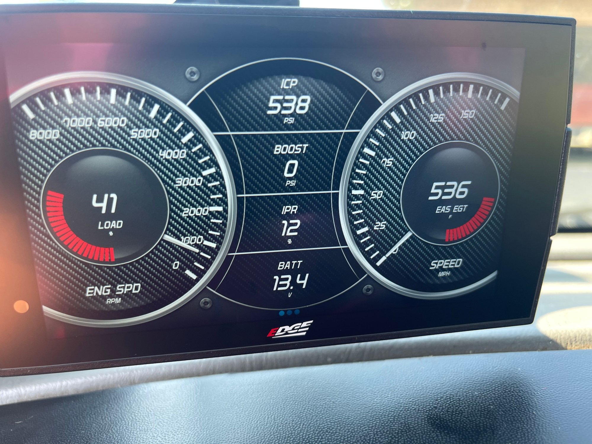

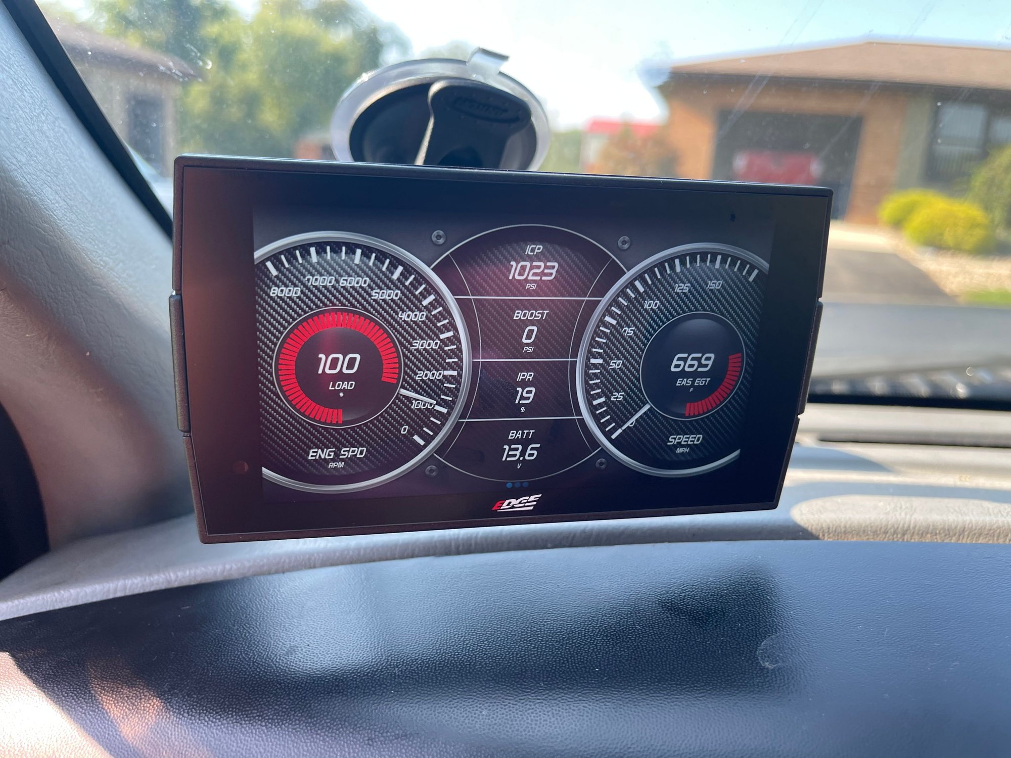

Load represents IPR DC I assume?
There may be a lot if air in the HPO system that needs to be purged since you introduced air into the system. Was there a lot if smoke when you first started it after the injector swap?

Yep tighten up the manifold to up pipe bolts to seal that leak. It will take some driving to work all the air out of the oil system, then it will run smooth.
Can you fill us in on what "load" means? It could be ICP DC as Sous mentioned, but I could imagine it being MFDES.

I'm honestly not positive what load represents on the cts3. It is worth mentioning that prior to my upgrades, I did have a hot restart problem twice, and driving to my dad's garage it shut off on me and I I was able to limp it the last half mile at 5mph with the load like it is. But it is absolutely not driveable right now as I can barely make it back up the driveway.
I don't doubt that there is a lot of air, I had used a mighty vac to suck the cylinders, rails, and hpop to try to get rid of as much of the old oil as I could. Every thing I read prior to doing this had people driving the truck for 50 miles to work it out, which just isn't possible.

The load thing I havent worked out what it relates to with the CTS3, it's part of their basic PIDs and honestly it's something I'm not very interested in monitoring. I do know that when cold it goes to 100% dead easy. Hot in gear idling mines around 22% from memory. Cold , I can't remember. As I say it's not something I look at.

These trucks can and will idle with very little to no fuel pressure at times. Not all trucks will, but some will. When applying throttle, the engine will sometimes stall or be very lethargic feeling if the fuel pump is failing or fuel pressure is very low. Ford states a minimum of 32 PSI post filter for an engine under load. We usually recommend not going lower than 40 PSI for an engine under load.
Not using the "load" dial on the CTS3 as a measurement until we are sure what parameter or PID's it is utilizing.

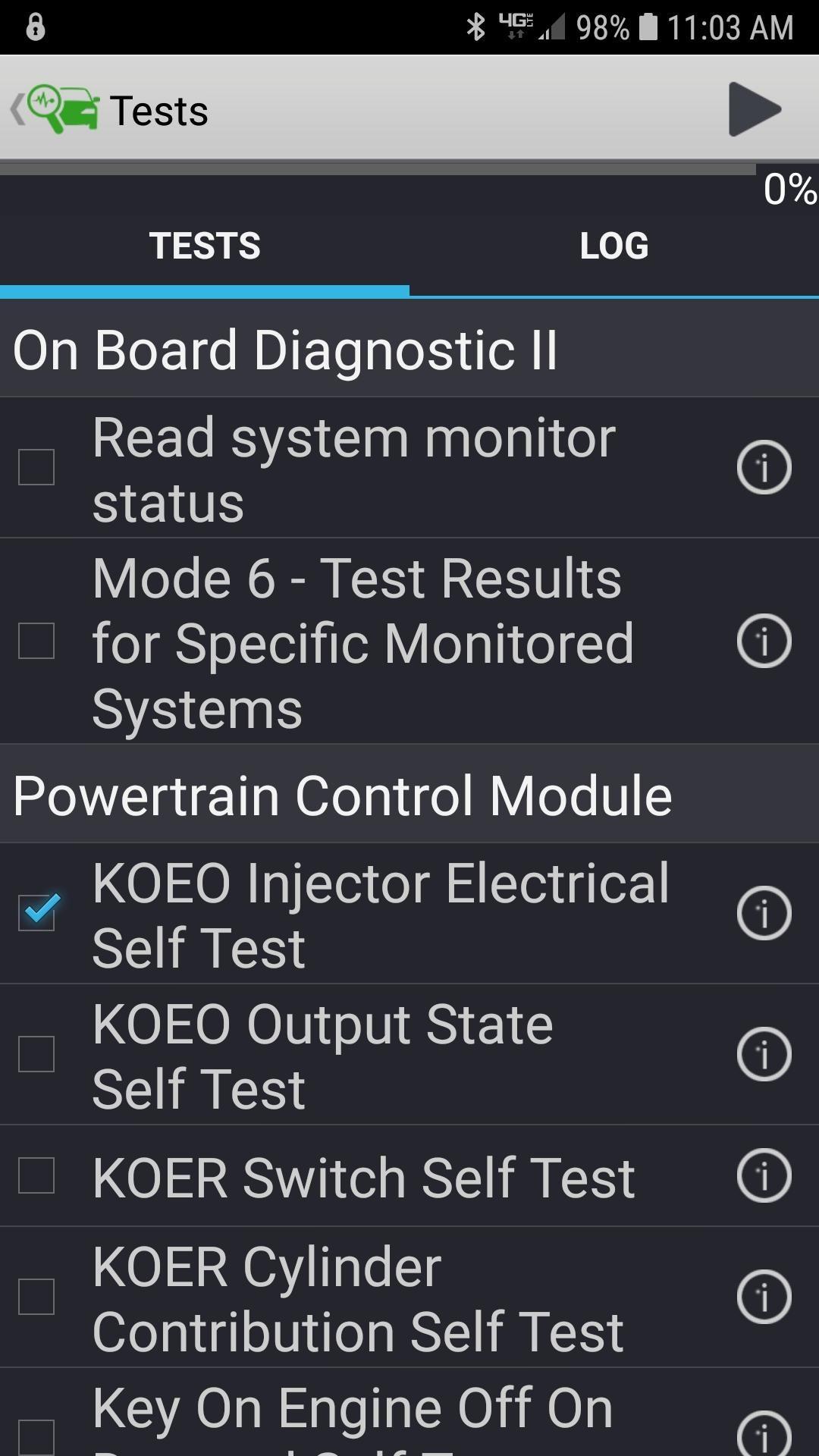

You can see what codes are stored by the IDM per that P1316 PCM code, by running a "buzz" test on FORScan Lite on your phone. It's called KOEO Injector Electrical Self Test:
