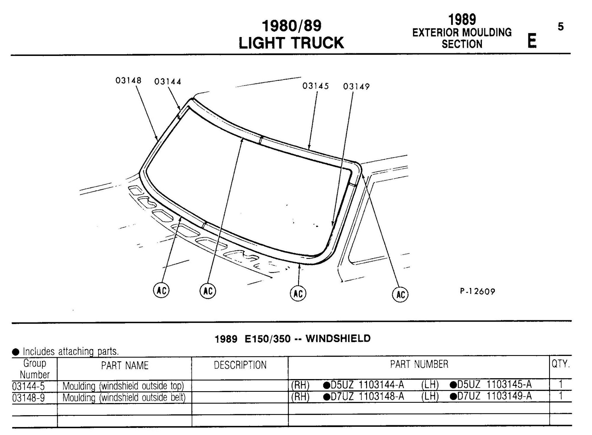

My 89 Shorty has chrome trim around the windshield, I don't believe it belongs on the van, previous owner screwed it to the van, he drilled the windshield frame full of holes around the glass to attach the trim, yeah, no way Ford installed this. I have rain getting in the rear of my van, pooling in the floor, I just replaced the rear door gasket, then I had to adjust the hinges so it would close, still getting water in the rear floor, now I can only deduce the wonderful trim on the windshield is to blame or the sealer in the rain gutter, which is possible, I can't get up there to see it, I can't imagine the cost to remove and replace the seam sealer, the windshield is $400-$500 to replace, its glued in, even so will that fill in the holes the idiot drilled around the frame. Well those are the only 2 places I can think would leak, the roof has no holes in it, the doors are solid, no windows, doors close tight.

Does the windshield trim seem to have factory bends? My mom's 78 E100 windshield molding is starting to come loose on the drivers side. If I remember correctly, there are little posts that look like small short nail heads around the windshield. There are some molding clips that snap onto the little posts and then the molding snaps to the clips.
Ford part D1AZ-6542413-B
Here is what the clips look like.
https://www.fastener.zone/products/a...d1az-6542413-b
HEre is the trim.
I doubt you will find new moldings but the good news is is that according to the part numbers, 1977-1991 should fit.
The question is why did he screw the moldings on? Is the windshield frame rusted and he filed the area with sealant and screwed the molding in place over the sealant?

The 89 windshield glues in, I don't know is it was supposed to have chrome trim, looks great with self drilling sheet metal screws every 6 to 8 inches, really irritated with such stupidity, the glass guy who came by ran sealer around the inside, dad wanted it temporarily fixed, I gotta get the guy to come back and replace it, he said it'll break on removal, so a new glass needs to be ordered. I am hoping the water running in the rear floor is not coming from the windshield, running to the back, but that would be worse, meaning the rain gutter, seam sealer is leaking, I gotta say, my 73 was in better shape body wise, no leaks and no rust holes, but the drivetrain on this has 70,000 miles, a fuel injected 300 I6 is far better than a 73 emissions gutted 302.

Dads driveway is inclined, thats why I figured it was the windshield, he said its the back door, so I have to replace the other gasket. There are no trim clips holding the chrome on the windshield, someone has put sheet metal screws all around it, I haven't taken photos of it, it was leaking pretty bad earlier, removal of the plastic trim inside will be a nightmare, its sealed to the glass with the black sealer, this whole thing is a nightmare, how will the front be sealed, the outside of the windshield having near 30 1/8" holes drilled all around the frame from the screws. I do miss the days of windshield gaskets, they even looked good, didn't require replacement of glass to remove and replace a seal.

Seriously though i wonder if water was leaking in around the windshield and the PO removed the trim and just flooded the gap around the windshield with sealant and then couldn't use the original clips because they are covered in sealant?
Now if you removed the trim you would have all of the screw holes which are bound to leak at one point as they are... Maybe JWA knows of a material that is suitable to seal around the windshield as well as be formed in a shape that would appear like a rubber gasket seal.. It wouldn't be anything a shop would do because it wold be too time consuming.

This is what goes all around the glass, screw holes all in the frame.
