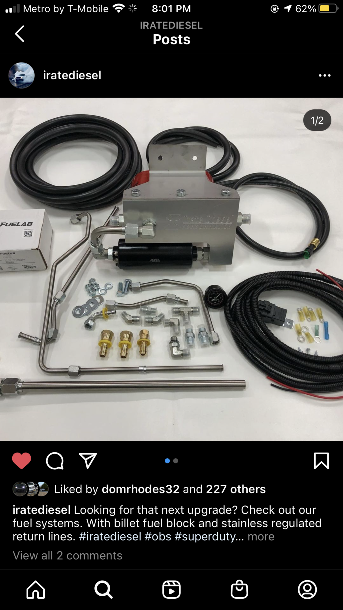

So I’ve recently purchased an irate diesel efuel kit and regulated return for my 1995 f250. I followed the instructions from the packet they sent and seems too have everything where it should be. I started it up and it turned on after a couple of cranks. It pumped the fuel the first coupe of times but it hasn’t been pumping it lately and causing it to not start up and when it does start up it has a choppy idle and slowly turns off. I disconnected the hose that connected to the block and put it in a jar to see if it would pump and it wasn’t pumping out anything the pump seems
to sound on once I turn the key but no diesel. I’m curious if anyone has ran this pump and has had the same issue or could it possibly be something on the truck itself ?

make sure the pump isn't wired backwards.
