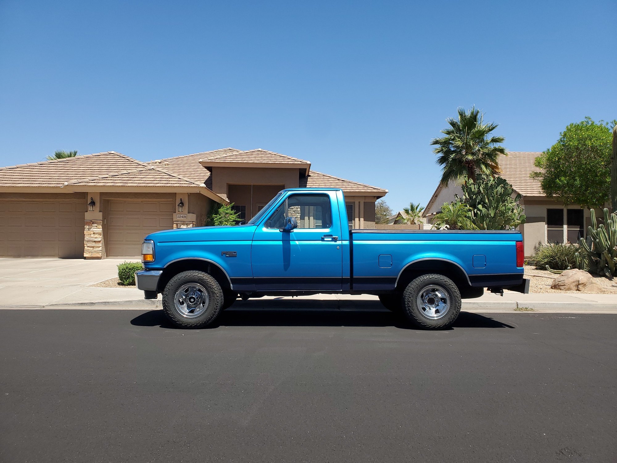

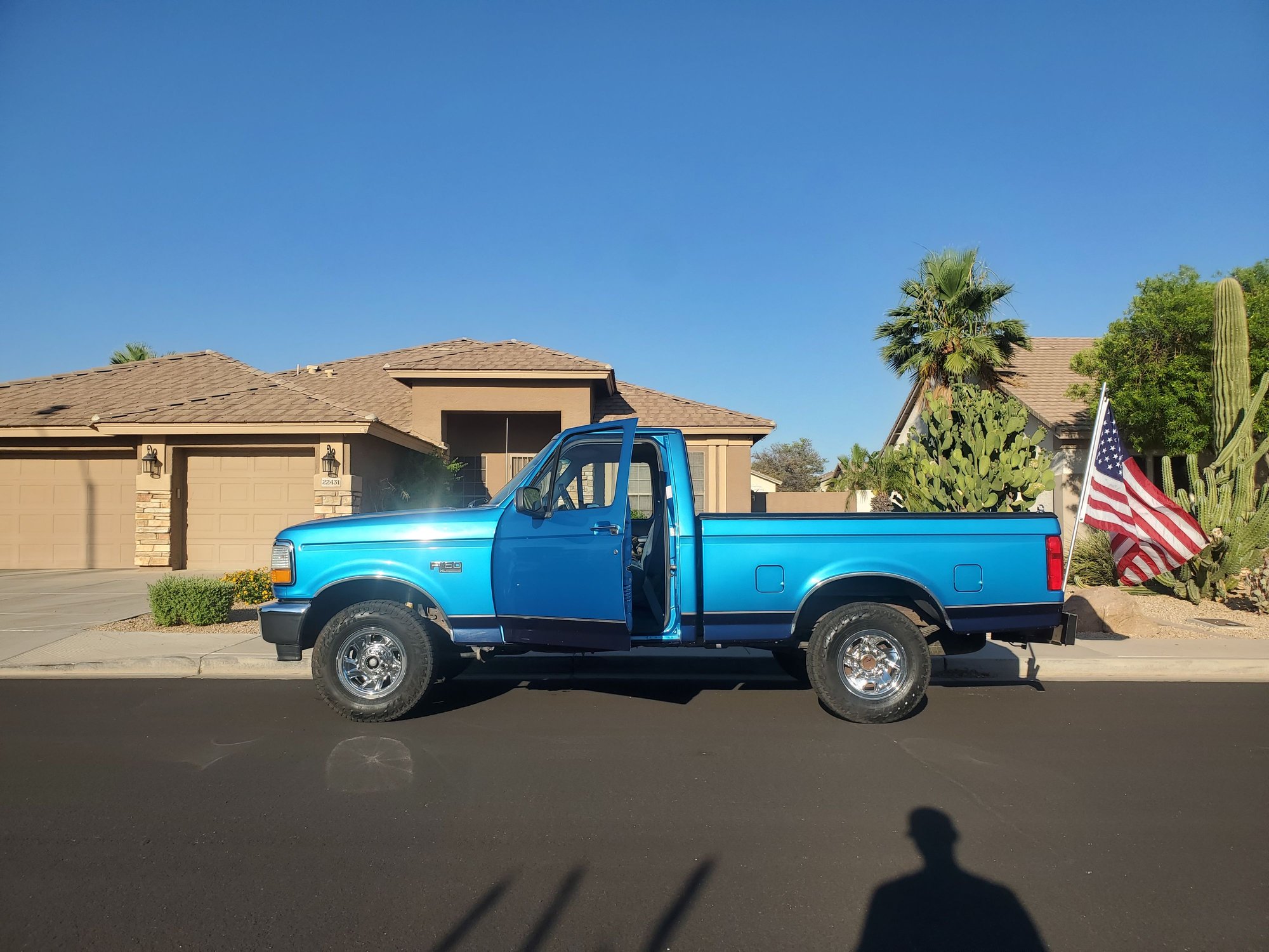

They will fit and the 3:55 gears work fine with them.
Old Jul 9, 2021 | 08:32 AM
JoeDirtOlSon's Avatar
JoeDirtOlSon
Joined: Jul 2021
Posts: 8
Thank you! Beautiful truck by the way!

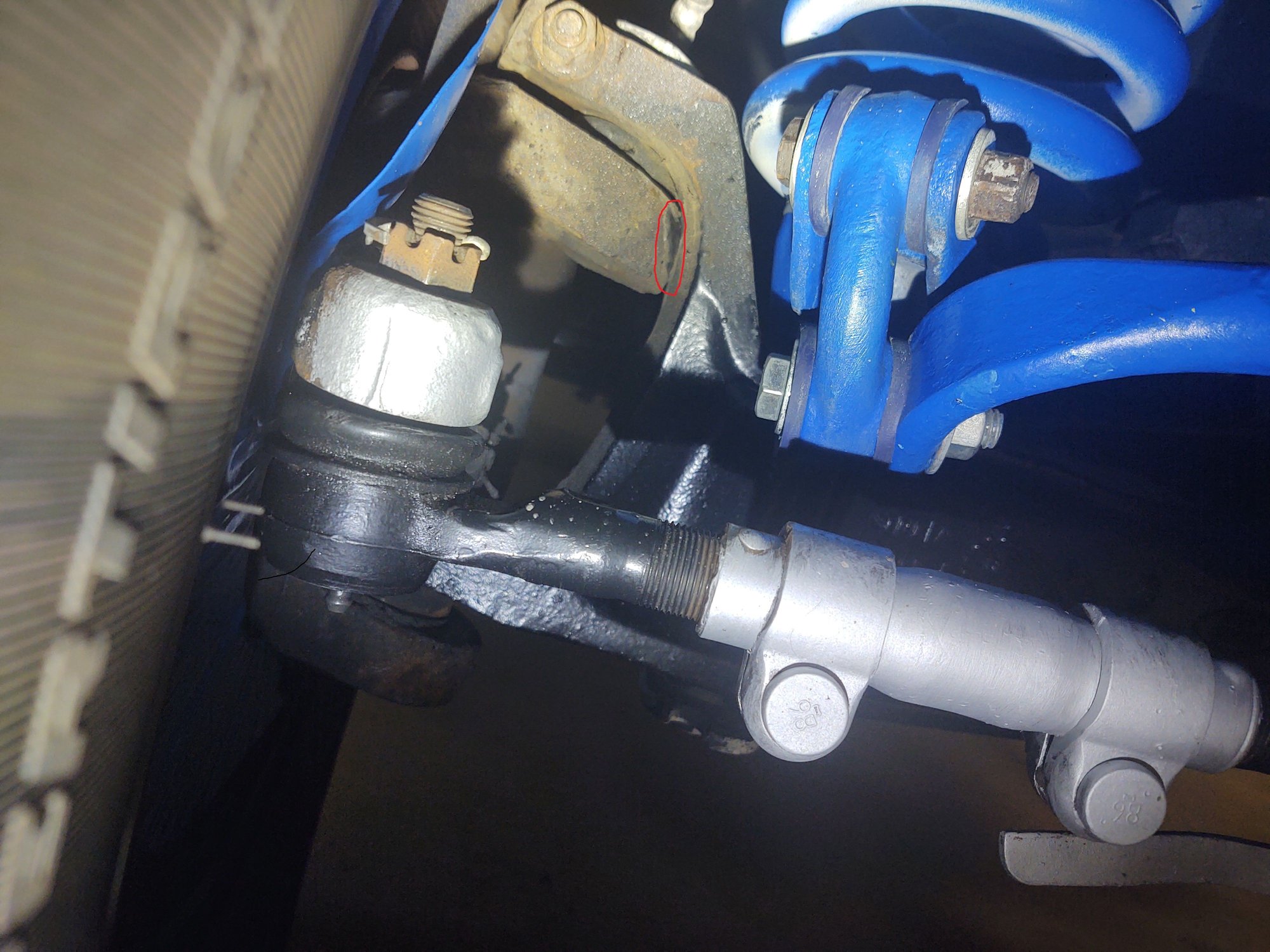

Do you have the center caps for the rear wheels? I think your truck looks great just like you have it. Plus it appears you have plenty of meat on the tires and I like your wheels. I am not sure the knuckle on the passenger side is like my 250 2WD but if so, I question the bigger size. Alignment might be an issue because of the 2WD passenger knuckle and maybe turning rub. I'm just not sure about the 150. Maybe someone can verify the 2WD will work.
Edit: I recently put Moog progressive springs in front and just with those and stock tires plus Bilstein shocks I can't get passenger camber in spec. . 2WD allows up to 2 degrees of camber adjustment and 4WD allows up to 4 degrees as I understand.
upper ball joint touching knuckle which allows for no more camber adjustment
