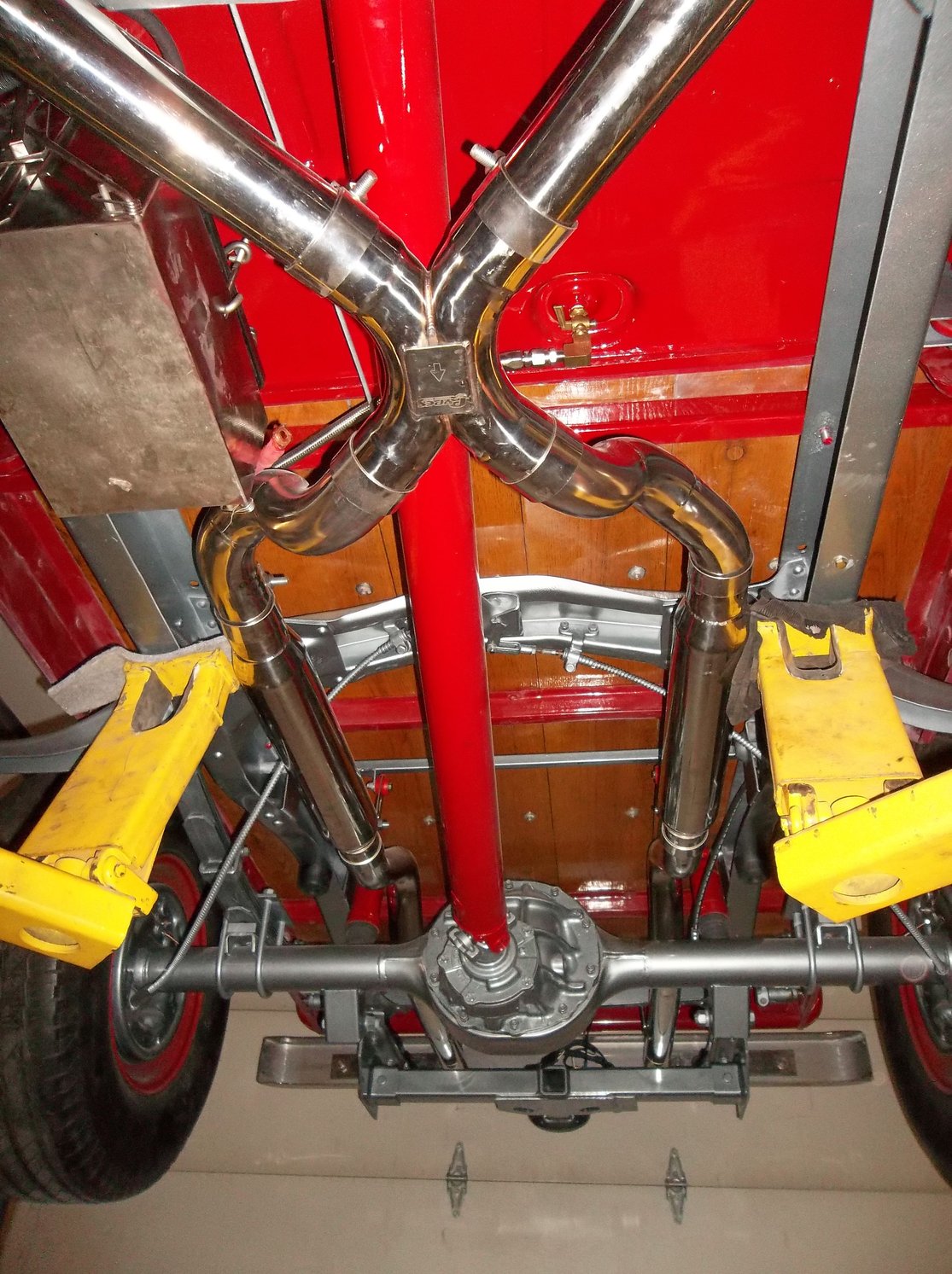

About 10 years ago I removed the original metal bed floor in my 49 F-1. I had essentially no rust in the bed but the floor resembled a bag of walnuts from use/abuse. I had purchased many years earlier a replacement properly ribbed metal floor (No longer available) and installed the new floor. Getting the new metal floor with some semblance of being flat was a real challenge. I used a spot weld cutter drilling from the inside or a die grinded at the spots, not penetrating the bedsides. I replaced the original wood that Ford had under the metal with oak.

Metal floor and varnished oak underneath
Note: Pictures before I gave up/changed out the SS cherry bombs.
