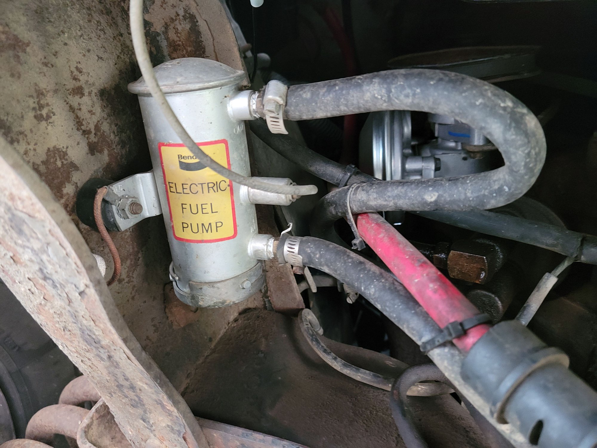

Thanks for all the responses. This working out of town business really limits my wrench turning time, but
I was able to fiddle around some more on the truck when I got back into town this afternoon. I checked the fuel pressure at the filter and saw 3psi at idle. I think this is low, but it didn't decrease when I revved the engine. I was not able to position the gauge in a way that would allow me to see it while I was driving, so I don't know if the fuel pressure holds steady while going down the road.
For some reason, whoever wired the fuel pump wired it directly into the fuel shutoff solenoid circuit. If I have time this weekend, I will rewire it with a relay and see what happens.

I believe it's supposed to be around 8-9 psi.

me thinks you found your problem. 3 psi at idle is way too low. should be closer to 7-8 at idle.
what brand electric pump is on it? my bet is a cheay mr gasket style gas e-pump.
you need a diesel rated pump, like the facet duralift 40285.
a lot of people have switched to the 40222.
best place i found for facet pumps is aircraftspruce.
https://www.aircraftspruce.com/catalog/eppa

All of the Facet pumps are diesel rated. When I was pump shopping for a generator I was shocked to find that an aircraft place had the best price on it, and delivery was fast. If the pump is mounted down near the frame one of the cheaper ones should be fine, but high up in the engine compartment the duralift might be necessary. I don't know why some people mount them in the engine compartment, seems like the worst place for it, but for some reason this is popular with IDI people.

yes they are. but the cheap solenoid types like the mr gasket pumps are only gas rated, even though they say they are for diesel too. that is why they burn out so fast.

The pump is an older Bendix unit. It looks to be the same model pump as the Facet cylindrical. I noticed in the daylight that it is plumbed in series with the mechanical pump on the side of the block. I'm guessing that the Bendix pump is a low pressure unit meant prime the mechanical pump and that the mechanical pump has failed. There is no smell of fuel in the oil.
I'm just going to order another pump spec'd at the correct pressure and bypass the mechanical pump all together.
I have attached a picture of the fuel pump as well as a picture of the truck.

If you just hold higher RPM in neutral it's not going to be much of a test. Doing a hard rev from idle might show something. If it were an automatic you could power brake it to also see what it does under load.
It's possible that the electric pump has failed and become a restriction.

Is the way to go on the electric fuel pump mod to leave the manual attached/installed or bypass/remove?
my 90 came with the cheap green one and feeds the manual. Only need it under heavy loads when the engine starts running out of fuel.
What causes this? Certainly the factory didnt sell these trucks with this limitation
