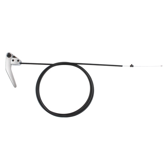

That said, looking at the picture of an interior release handle unit it looks like there's more movement built into the handle shaft than is necessary to move the bar to the latch. You could remove the bar and attach the cable anywhere along the lever to accommodate any amount of throw necessary to pull the cable the required amount to trip the bear claw. It wouldn't take much, but you want enough to move the handle several inches and not have it trip too easy.

While looking for the picture of the handle remote above, I ran into this nifty deal. Something like this could be incorporated and hidden within the arm rest if you didn't want a big exposed handle.
https://www.speedwaymotors.com/Bear-...CABEgJRhfD_BwE
