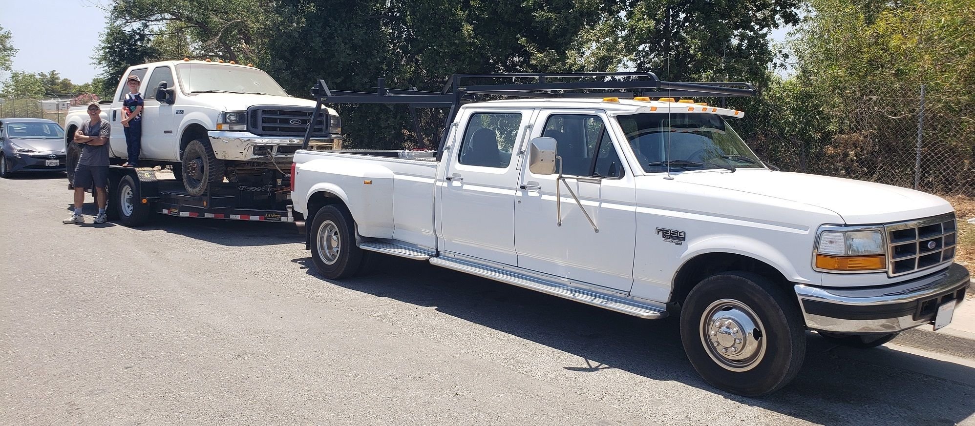

Another successful tow in the books. Several hundred miles, a few climbs, close to GCWR. Slight fish-tailing tendencies just over 50mph, but the '97 delivered yet again. Beast of Burden for sure.

Sooooo, what are you doing with that Superduty??? Future project?

Planning to harvest the axles et al for conversion of my '97 dually to 4WD. Though there is an outside chance I resurrect (or attempt to resurrect) the 6.0L PSD in the donor vehicle first.

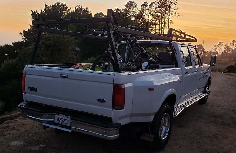

It was fun hauling the dump trailer, the donor F350, and the heavy log loads, but this is the best load yet. Looking forward to hitting the national parks, coast, canyons, etc., with the family. I'll warn them to bring headphones for the ride in the PSD cab.

Ok, now you have my my most desirable setup. Nice!!!!!
