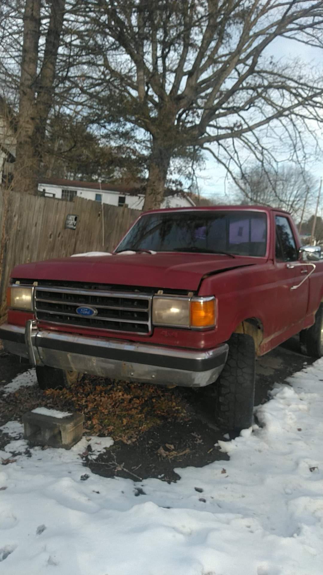

90 model f150 300 straight 6 4x4 manual transmission short wheel base regular cab.
New-
Complete distributor with ignition module, Ignition coil, starter, Battery, Plugs, Plug wires, Computer, Fuel pump, Fuel filter, Fuel pressure regulator
ran good for an hour then we turned it off came out the next day and started it again it ran for about 10 minutes then acted like it was either losing fire or running out of gas then eventually just quit since then haven't been able to get it to hit or run since then the coil is getting power and is firing the fuel pump is running and building pressure as far as I can tell pulled the distributor cap and made sure the rotor button was still turning to rule out the fiber gear being broke. Any help would be greatly appreciated I've just about gone crazy trying to figure this truck out
