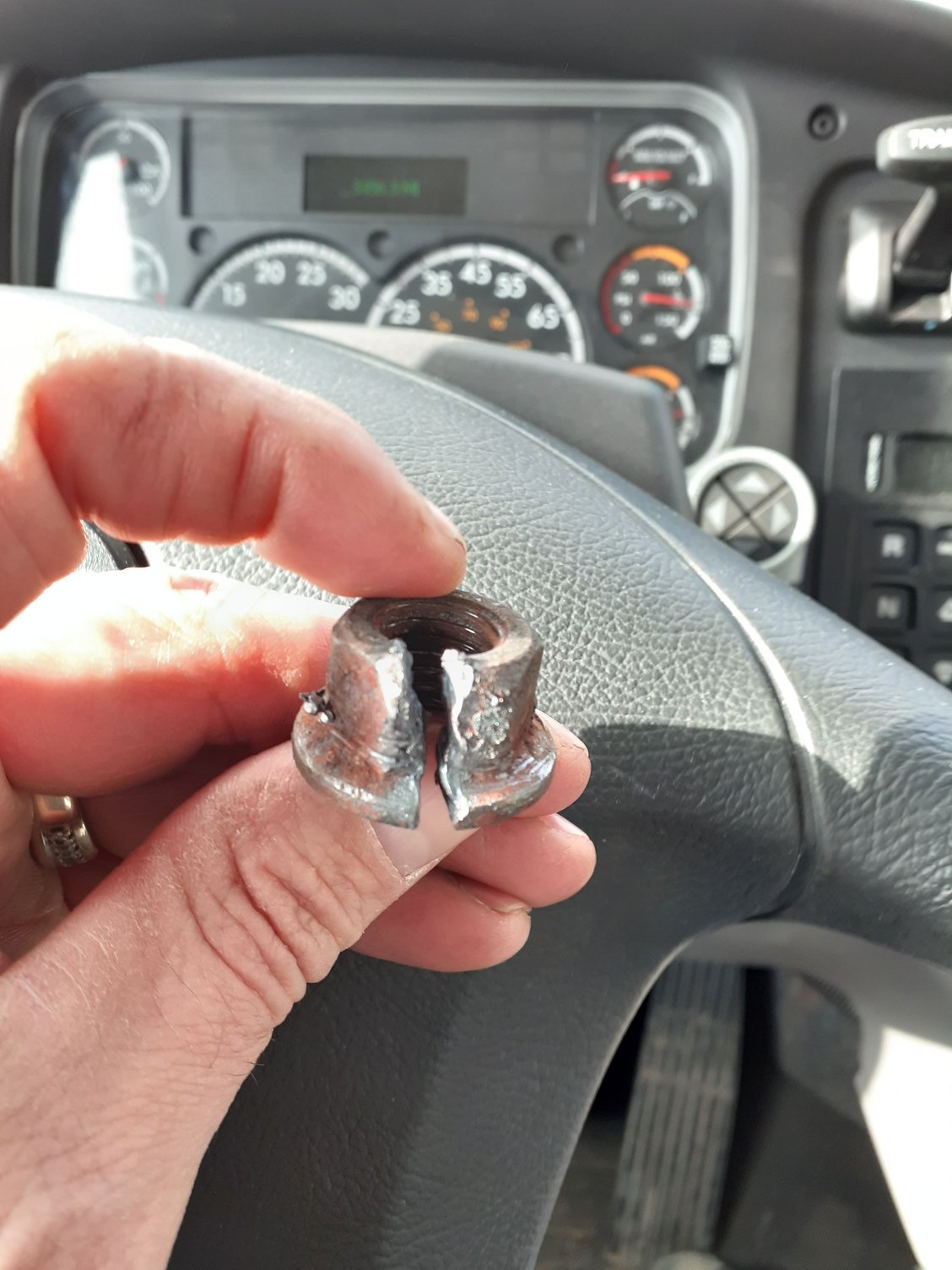

After crawling under the truck and bending up the angled capture plate (made if sheet metal), this is what the nut looks like:
As you can see, there is no way to get a wrench on the nut. I tried to fabricate a wrench from some plate metal that slid in between those brackets only to have the nuts still round out.
Long story short, the ONLY way I could find (including an air chisel trying to split the nut), was with a plasma cutter. It made short work of the nut. I had to grind the head off the bolt, raise the bed, then cut the nut. Well, I didn't, my son in law with the plasma cutter did!
4 new bolts and 4 new captured nuts ($67.21) later, its back together.
