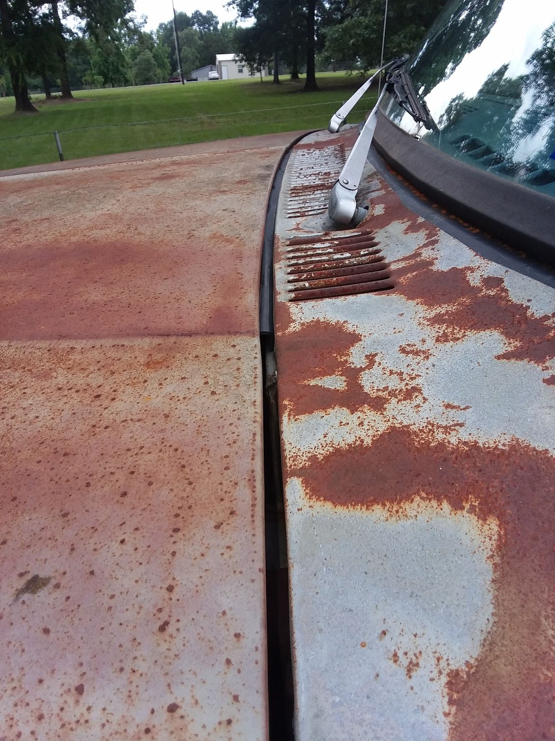

Well after getting the fender off, I found that the seam in the upper center of the first picture is inaccessible. I think the water is actually getting there by running down the front seam inside the cowl which is also inaccessible.
I'm gonna clean and protect the area as best I can and maybe come up with a solution after a nights sleep. Maybe some sealant on the screws????
