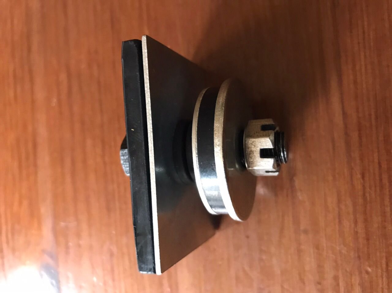

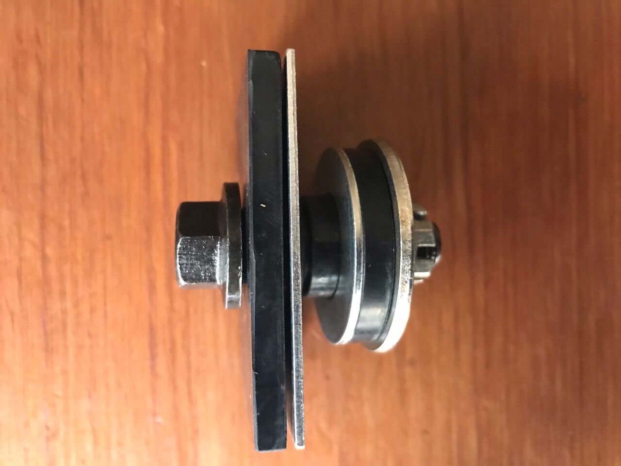

Going over our build and checking some things. Wanted to make sure we have our cab mounts assembled correctly. I took these pics for the #1 mount, does that order of parts /direction look correct?

I can't quite tell from your assembly what your orientation is. The drawing is straight out of the factory service manual. You should have two rubber pieces, one flat and one T shaped. The small end of the T rubber sits in the hole on the frame mounting bracket. The cab sits on that rubber. The bolt goes through all that from the top side, then the flat rubber, flat washer and nut attaches on the bottom of the bracket. You just want to snug everything up to remove slop or play, not overtighten or squish the rubber, similar to installing shock absorbers.

I broke it up to show the parts. Not sure what you are referring to as the T part.

You have parts that aren't shown in the drawing. No matter. When I spoke of the 'T', I meant looking at it from the side, the shoulder that fits into the hole in the frame bracket makes the rubber look like the letter T. The drawing has only the upper pad (the square one) with the shoulder. Both of your rubbers have the shoulder. But comparing the drawing with your exploded view, I would say your orientation is correct.

I just did mine a few months ago. The Dennis C. kits are a little different than original. Your orientation is correct for the front-most mount. I'm going to disagree about tightening; the shoulder on the bolt hits the bottom washer when it is all tight.

Given this information, I will revise my recommendation and agree with Ross. I didn't consider having a shoulder bolt to tighten against, since the drawing showed a castle nut and cotter pin.
