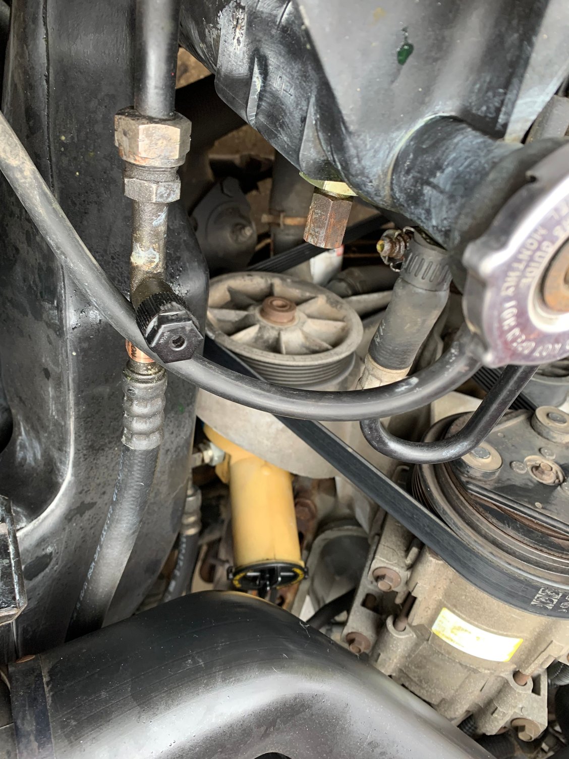

Hey guys, I have a 1995 Ford F250 4x4 XL. It has a 7.5 460 Automatic Transmission. My radiator is split and I need a new one. However, I have this line and I DO NOT HAVE ANT TRANSMISSION COOLER LINES PLUGGING INTO THE RADIATOR. The radiator coolant line ports are plugged. I have another smaller radiator in front of the main radiator which I believe is another cooling radiator. My question is what do I do? Do I buy a radiator for automatic transmission and plug the two ports like it is now or should I buy a radiator for a manual transmission with no ports? I'm confused, which is normal for an old man my age, but what is this long line in the picture and should I be worried that I have no transmission cooler lines plugging into the radiator? The truck runs great apart from the radiator going bad. Any thoughts? Please help!

That picture doesn’t show anything about the other “radiator”. Is it the condenser for the air conditioner? Is it an auxiliary cooler for the transmission so the previous owner bypassed the one in the radiator and is only using the auxiliary cooler? If you follow the hose that runs across the top it goes back to the throttle body. The replacement radiator would work for either automatic or manual transmissions. It will also have the port on the filler neck to connect that line.

I thought only the 5L/5.8L trucks had the throttle body coolant lines?

However, I have this line and I DO NOT HAVE ANT TRANSMISSION COOLER LINES PLUGGING INTO THE RADIATOR. The radiator coolant line ports are plugged. I have another smaller radiator in front of the main radiator which I believe is another cooling radiator. My question is what do I do? Do I buy a radiator for automatic transmission and plug the two ports like it is now.
Buy the correct radiator for an automatic transmission truck. Re-plumb the transmission cooler lines like the factory did. Transmission fluid supply line goes to one of the radiator transmission cooler ports first. The other transmission cooler port goes to the input of the exterior mounted transmission cooler in front of the radiator. The output port of the front mounted transmission cooler then goes to the return line port of the transmission. Someone mistakenly plumbed around the factory transmission cooler in the radiator. That's a big no-no.

Send a photo showing the top of the engine. Something that shows the upper intake manifold and throttle body. I am very curious after you sent the photo that shows a throttlebody cooler line. I thought only the 5.0/5.8L engine trucks got those cooler lines. Could be wrong

The separate throttle body cooler line isn’t going to hurt anything. I procured one from the junkyard and added it to one of my trucks that didn’t come with it from the factory.

Just checked it out on my stock 94 F250 460. It goes to a tee in a heater hose which goes to a fitting below the thermostat housing. I'm sure mine is stock, hope this helps.

Yes it does help. It's not used for throttlebody heating as I suspected. Perhaps a bypass path so water flows through the heater core when the thermostat is closed?

On my 351 it goes to the top throttle body port.

Here are the pictures
Both transmission lines feed in and out of the small cooler in front of the main radiator and I traced them back to the transmission. There is a t in the metal line that comes from the top of the radiator neck and splices into the other 2 what I believe are heater hoses. All I wanted to do was replace a leaking radiator now I have this mess on my hand. For an old man who lives to tinker on vehicles this has taken on a new meaning. I would like to put everything back right. If I get 2 flexible hoses and route them from the passenger side of the transmission and plug them into the radiator and do away with the oil cooler in front would that work? Thanks for any help!
