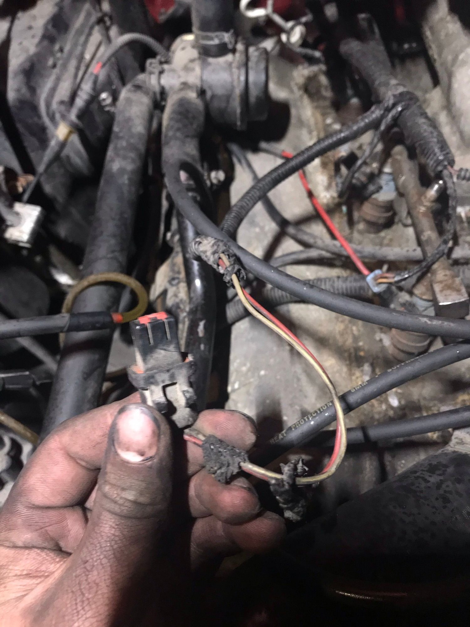

Where does this connect too?
It’s on a 94 F350 460, passenger side connected to fuel rail harness. I don’t know where this goes I’ve looked and looked!

Purge sensor

Charcoal canister purge solenoid.

Evaporative Emissions Control System to be exact.

Originally Posted by sandymane
Purge sensor
thankyou , that explains my purge valve code, hopefully it’s the reason why my car keeps dying when warming up
