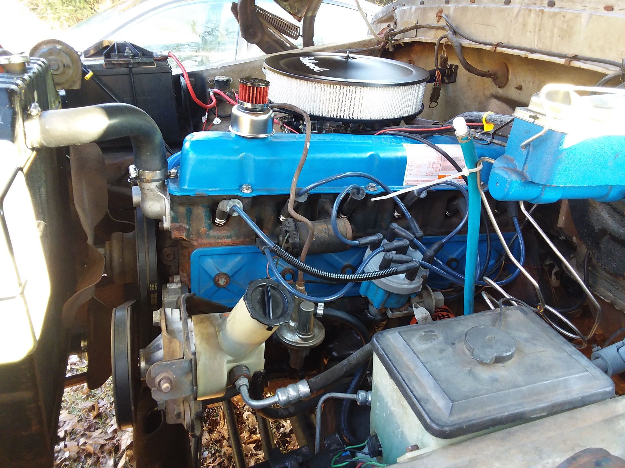

i love all the advice. i don't have a problem with too much information.
my brain can pick if it has options.
and i love the pictures
it is exactly like my engine compartment except for all the new paint and the little air filter on the breather cap
i was cleaning my air filter cover the other day and wondering if it was black all the way to metal
i may never know . . . but
the truck starts every single time and has the twenty or so years i've owned it
and in those 20 years it is the only vehicle i've owned
but at 43 miles an hour, down a country road, it makes the sweetest music i've ever heard, pretty much
sometimes i think it would be nice to be able to go over 65 mph , , , , i have a granny gear . . . but then that's what route 301 is for.
