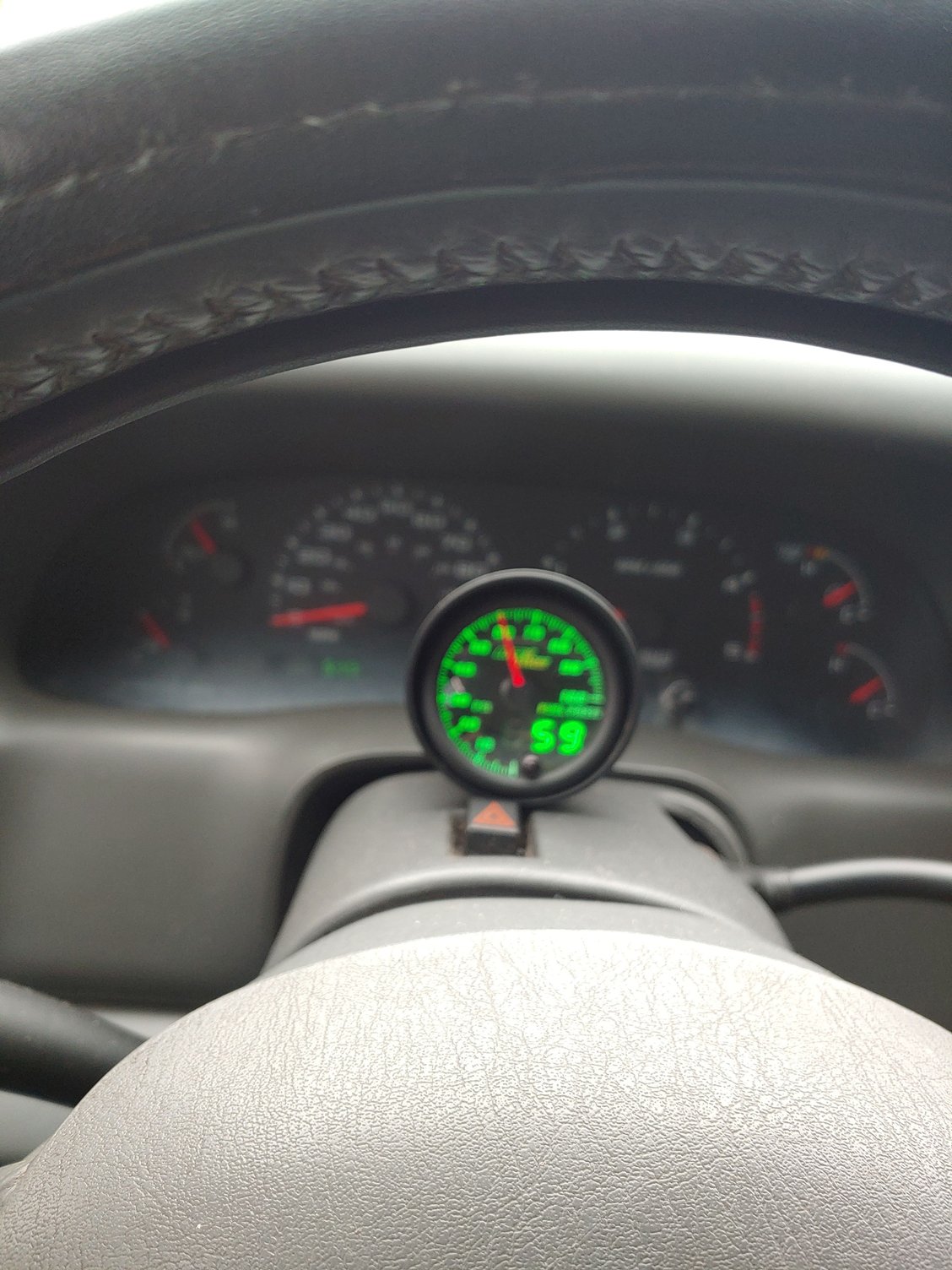

I just went and took a ride again to see what it will do on a fresh run. High at idle was 67 psi. Only dropped as low as 59 WOT. Settled down a little and did some town driving and stayed in the 62 to 65 range. Evan earlier today at idle or Cruz it would build back to 65. Will do again tomorrow. On another note I am reading a Maxtow digital gauge. Have herd stories about there reliability. Will keep looking. Thinkin I might want to order spring kit.
Will do jug test if necessary.

I'm at 67 down to 59, then just out of the blue when I take off she drop to 35 to 40. I let off peddle and it'll shoot back up to 67. I think I'm gonna just put a new Blue spring kit in it just to be safe. With it jumping back up so quick I don't think it's a supply issue.

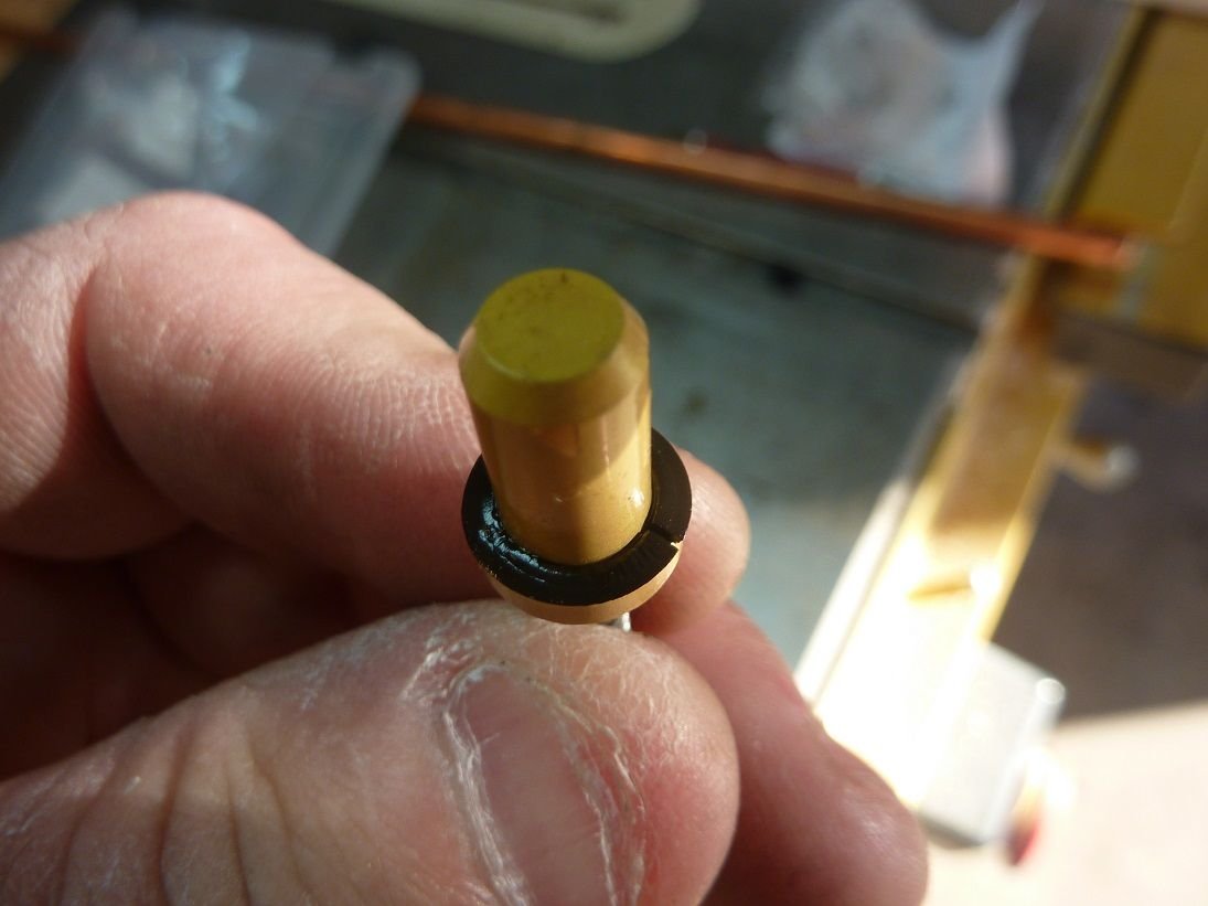

Well new oem blue spring kit installed. Oring on spring insert was really bad, pic below.
Thank God I didn't have to start the supply diagnostics. No tank test this time. One more thing. I think it took me longer to take out and install that dam air box than it took to do all of the other work. What a pain in the ***. Pour design.
I am getting 61psi at idle and down to 56psi at WOT.
not bad I guess.
