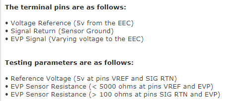

what year, should be right behind throttle body, on upper intake(see pic), you can test it, could have broken vacuum line, and also check that it is electrically plugged in, and the solenoid for it is plugged in, it is by your coil, on driver side, of upper intake, with 2-vacuum lines, green one goes around intake to top of EGR, the black or red one comes from the VRES(coffee can, depending on year), on passenger wheel well.
how to test EGR
Ford Fuel Injection » EGR Valve Position sensor (EVP)
EGR by throttle body
solenoid by coil
