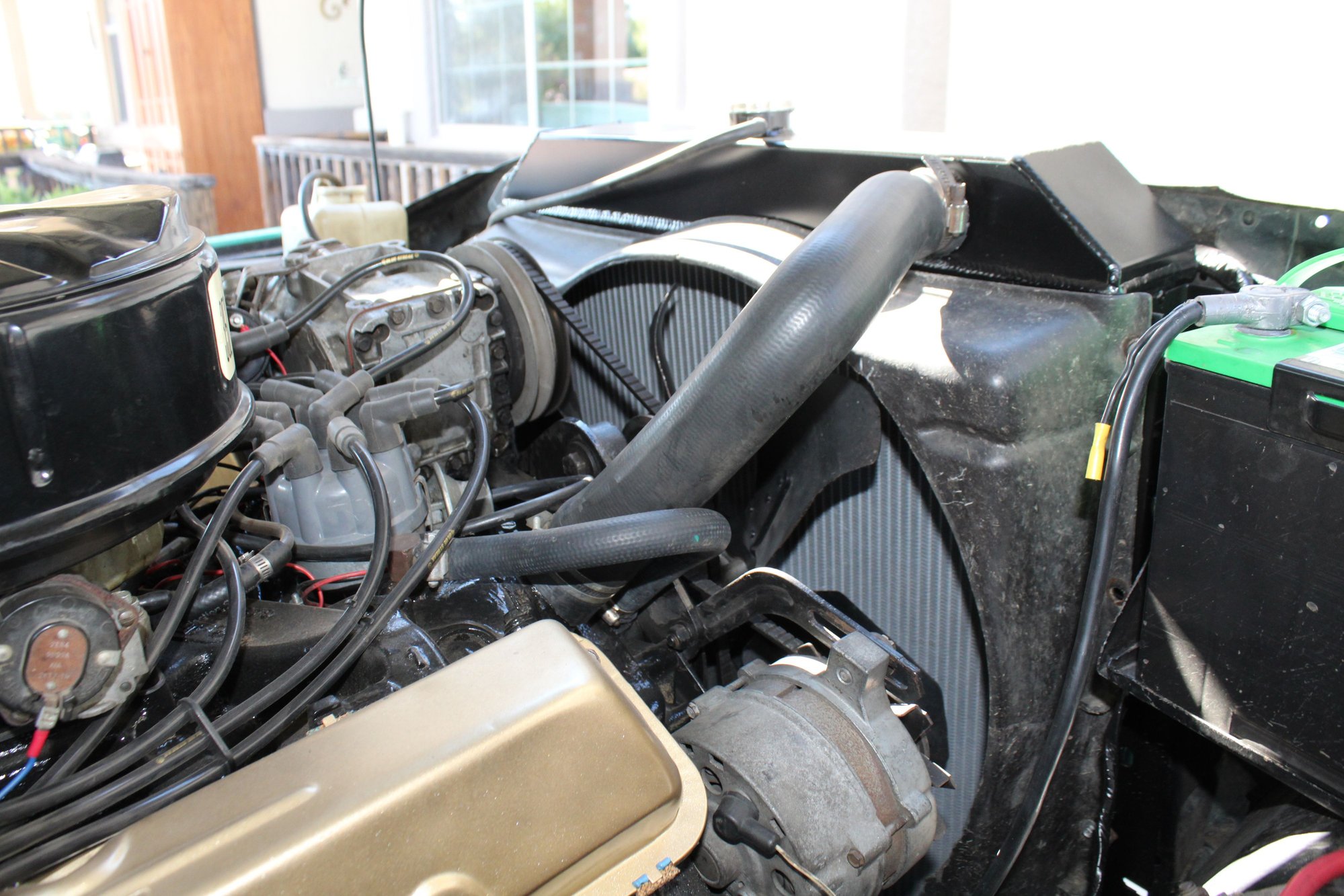

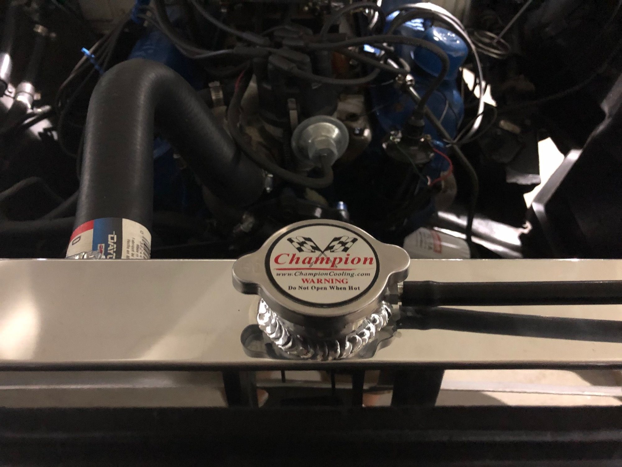

Not sure this will help or not but I just replaced my radiator on my 65 f100 2 weeks ago... I would call these guys up and see if he can help ya out... I don't think I paid more than 250 to my door... It fit perfectly...

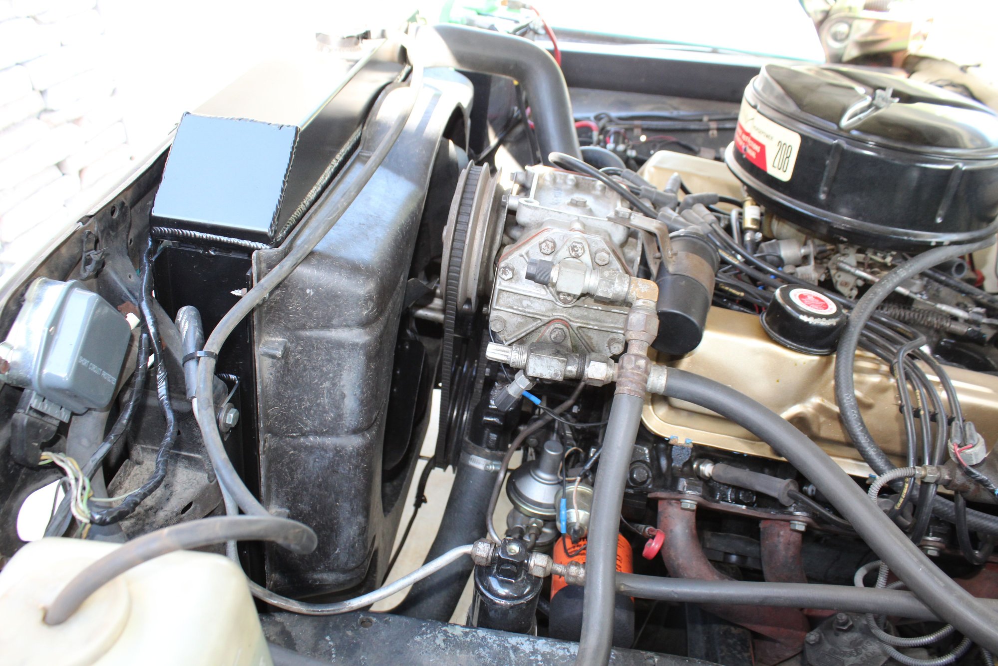

Similar to JackDerby, I installed Champion alum radiator. Years ago I had modified a mid '70s truck radiator since it was a bit bigger and gave me a shroud as well. 6 inches taller times 3 rows, you do the math. My aluminum replacement was for same application. Only slight modification was needed.

Bottom of the mounting flange needs to be notched a bit to clear frame rails, etc. Mostly on the driver's side.

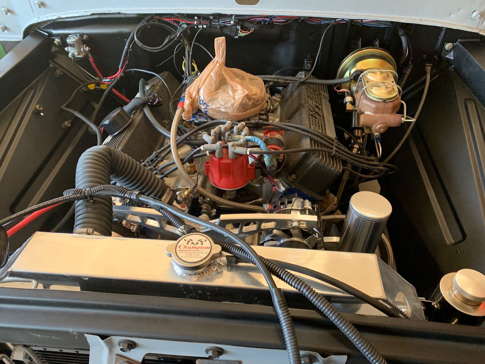

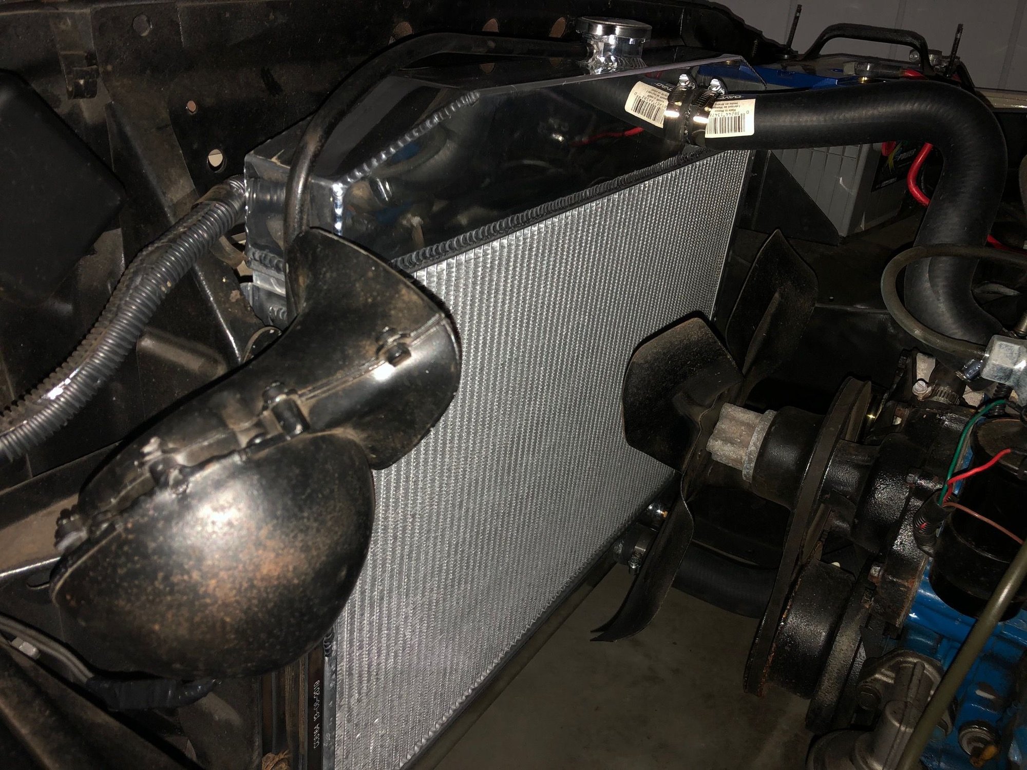

I have the FE my radiator is a champion and works great.
I also have my old radiator I can part with it if you’d like for dirt cheap and you also cover shipping but I will tell you that if you do your research on this sight you’re gonna find great things about these radiators so you might as well dive in and pick one up.
