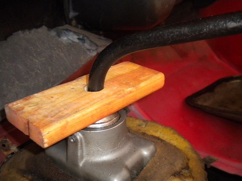

NP435 shift lever retainer cap (B8T-7220-D) has two notches, is retained to shift tower by two pins. See 1st pic.

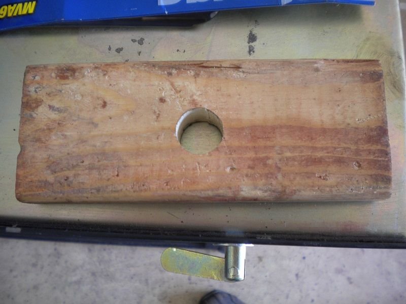

To remove this cap, it must be presseddownand helddownwhile turning it counterclockwise to remove it. (Its spring loaded and twists into place, we removed one and it was a 2 person job. Put the trans into 2nd, 4th, or reverse, then one person holds the cap and applies pressure, twisting in a counter clockwise direction. The other person hits it from the top with a hammer to get the cap to go in below the two clips that hold it in.) People unaware use pliers or channel locks to remove it, which tears out the pins. The block of wood trick works great.

You can also take the shift **** off and slide a large box wrench on top of the cap to get some downward pressure to remove it.
