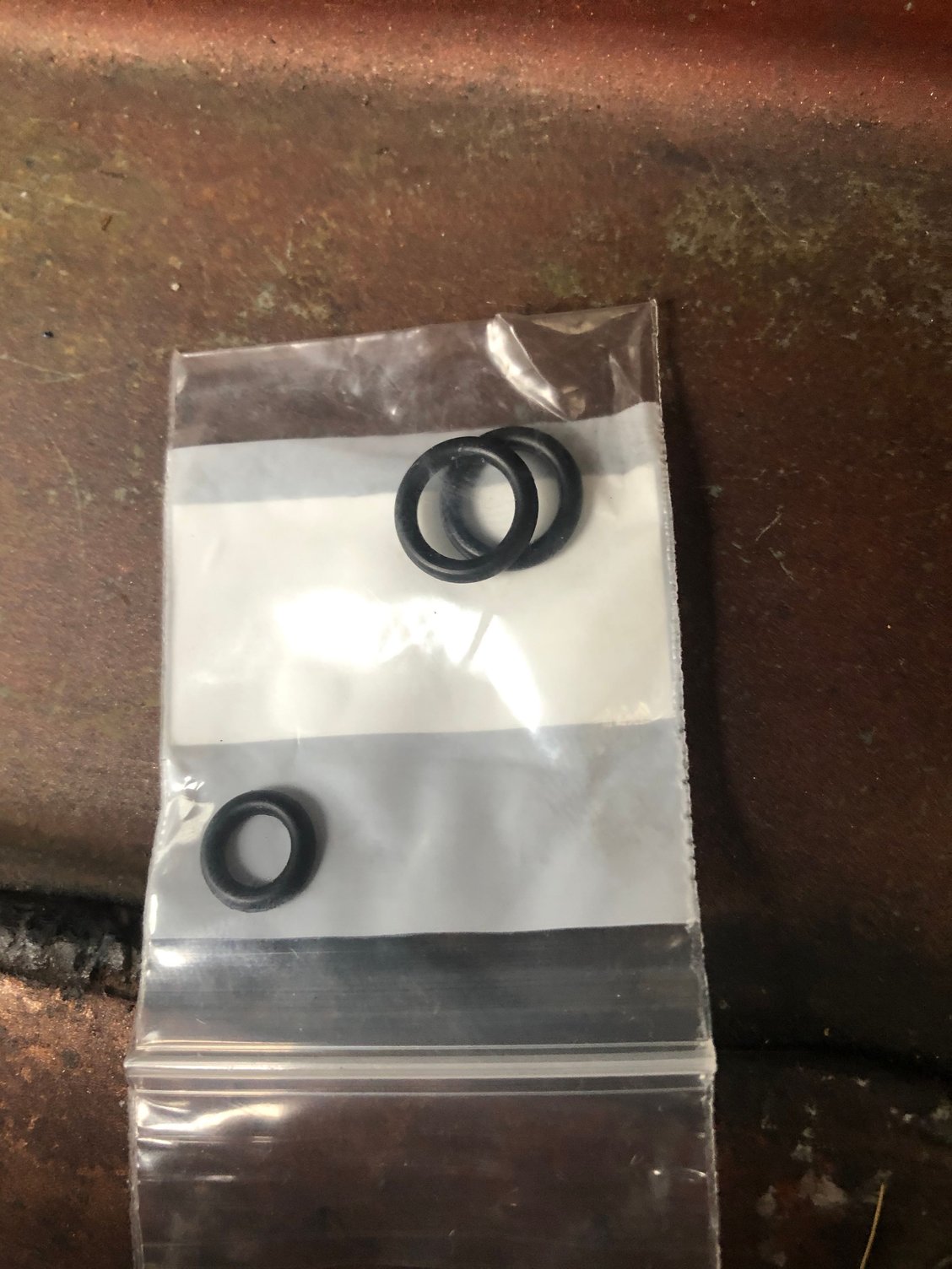

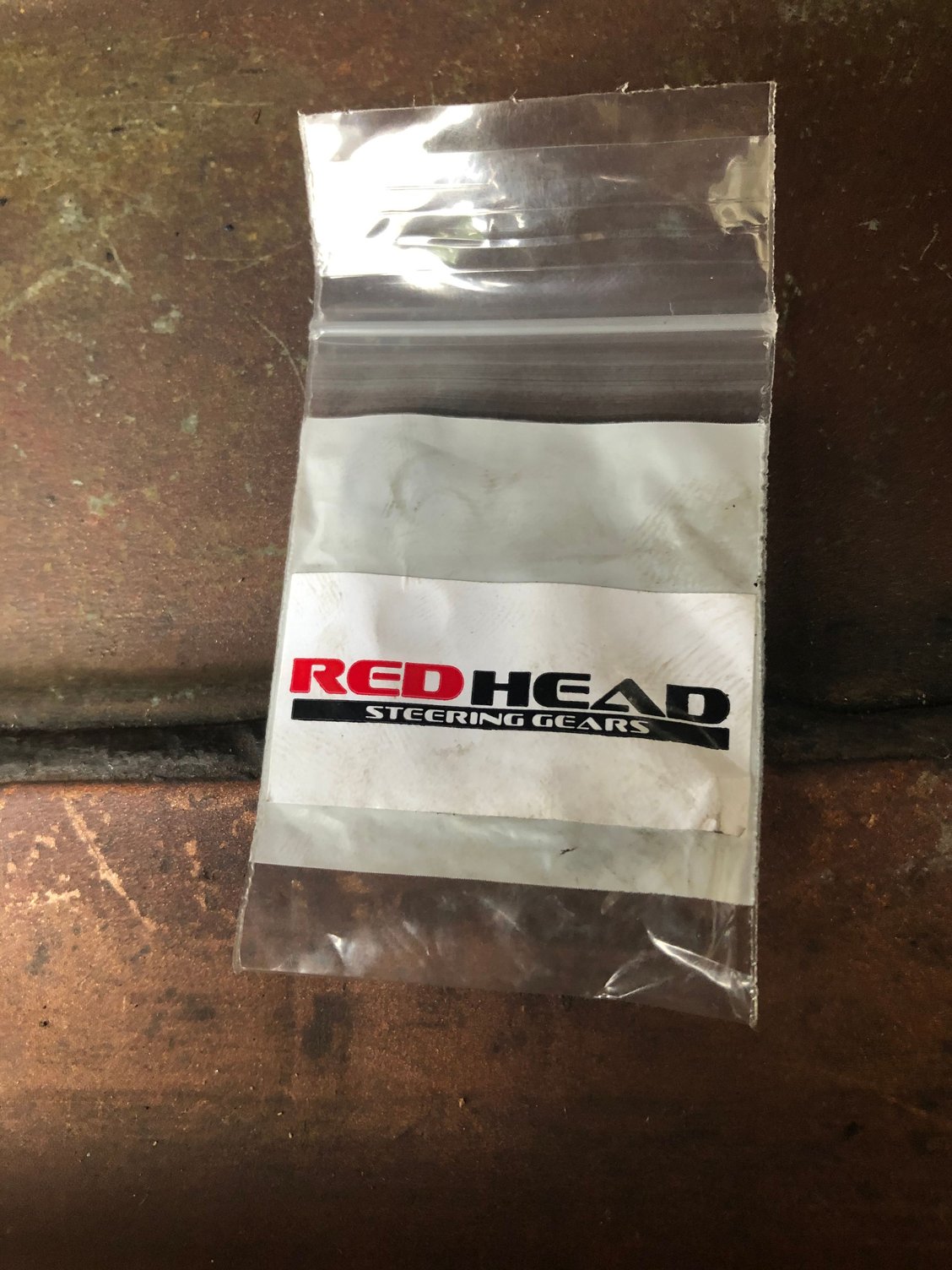

Hey everyone,
dumb question, but what are the tiny gaskets that came with my RedHead steering box for? My understanding was that there is no gasket between the PS lines and the box and this is why they are prone to leaks if you don’t keep the connections super clean. Is this not true? Truck is a 77 f150 4x4 C6 400. Thanks!

I see there 2 ways you can go with this:
1- call Redhead to see what they have to say.
2- look into where the lines hook up and see if the seat will line up with the lines you have.
I want to say your lines are flare so the box should have the same.
I think the later boxes use the rubber O-rings on the end of the lines that would seal on a flat seat in the box.
I would look at #2 maybe even take a picture or 2 before I did #1 and you could send them a picture or 2.
Could be someone put the O-rings in with the wrong pump?
Dave ----

They include them in case your set up needs them. if you don't need them don't use them..
I am pretty sure the line seat in the Redhead box dictates what hose end needs to be used.
If the seat is cone shaped like the end of the hose flare then no rubber O-rings needed as the flare dose the sealing.
If the seat is flat and the hose end can take a O-ring then it needs the O-ring.
And you cant mix n match them.
Dave ----

Exactly. they include the O rings and if you don't need them you don't use them. they're out 11 cents and no customer ever gripes because they need O rings.

Originally Posted by maribou912
Dumb question, but what are the tiny gaskets that came with my RedHead steering box for?
Truck is a 77 F150 4x4 C6 400. Thanks!
These O-Rings have nothing to do with the P/S gearbox. These are for the 1978/79 C-II P/S pump pressure hose.
1978/79 F100/350 & Bronco use the Ford C-II P/S pump that has a plastic reservoir.
The P/S pressure hose on the pump end has a straight tube with an O-Ring on it, connects to the pump w/a qwik connect fitting.
There are 2 different sizes of O-Rings for these hoses.
1967/77 F100/350 use the Ford/Thompson "pencil neck" P/S pump that has a steel reservoir. The P/S pressure hose threads onto the pump. There is no O-Ring
