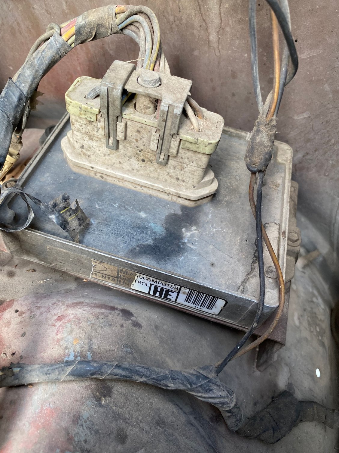

I know you guys said the computer didn’t start until 83, but isn’t this a computer in my engine compartment?
That looks like the oddball Ford MCU system. Even more of a pain to work on and try to get parts for. This thing must have been bought in California. I would get rid of that as fast as I could. Looks like you do have a computer, one of the very first primitive systems we don't see very often.

I don’t think it’s doing much anymore. Was its purpose strictly to regulate emissions or does it do other stuff too? Not sure it could be doing much at this point since carb and distributor have been changed to simple non feedback types, o2 sensor disconnected, vacuum hoses capped off, etc. What other components might it be connected to?
