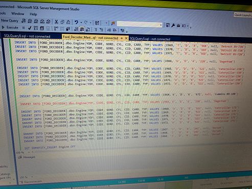

I'm working on an automated VIN decoder for our trucks. It will be a bit more thorough than some in the past since it will account for the larger trucks as well with the Detroit, Caterpillar and Cummins diesel engines, etc.
Here's a snippet of the SQL code
