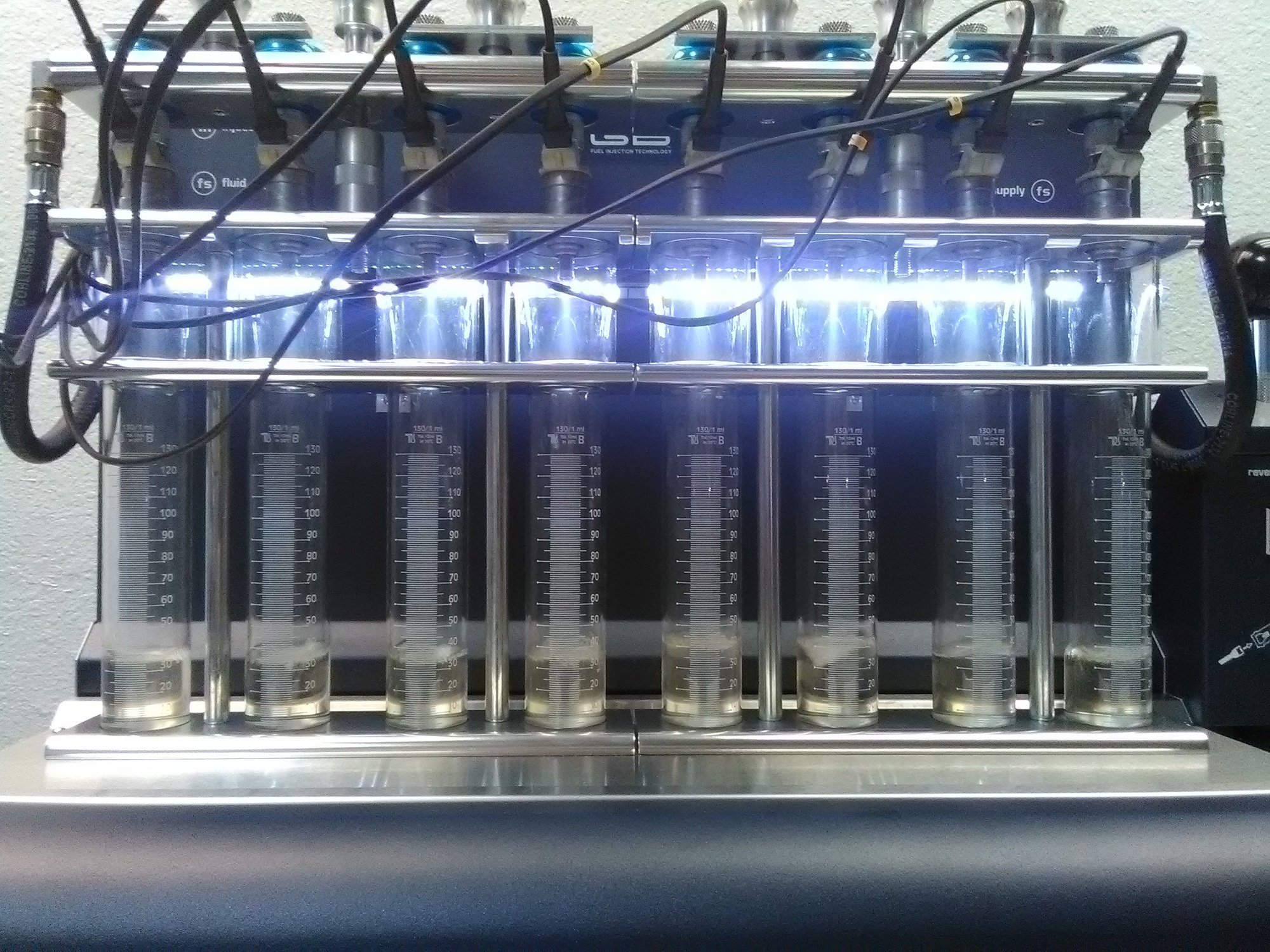

Originally Posted by gonzojr
Those are just shy of 19 lbs but will work just fine.
what tells you this?
Old Jun 22, 2020 | 11:38 AM
gonzojr's Avatar
gonzojr
Joined: Dec 2009
Posts: 20
I rebuild injectors. I know most of the flow rates. Here is my test bench
Old Jun 22, 2020 | 05:39 PM
torq'ta 5 8's Avatar
torq'ta 5 8
Joined: Jan 2019
Posts: 5,070
Likes: 863
From: N.W. Alabama
Hmm, good to know, do our stock 19's flow 19?
