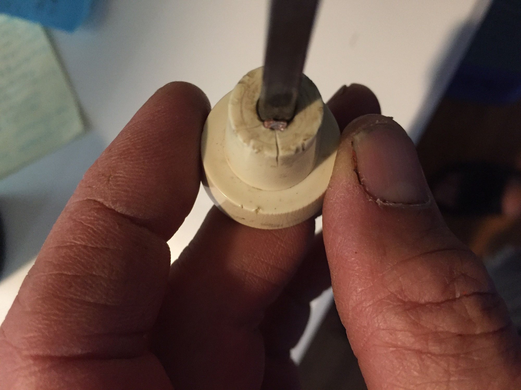

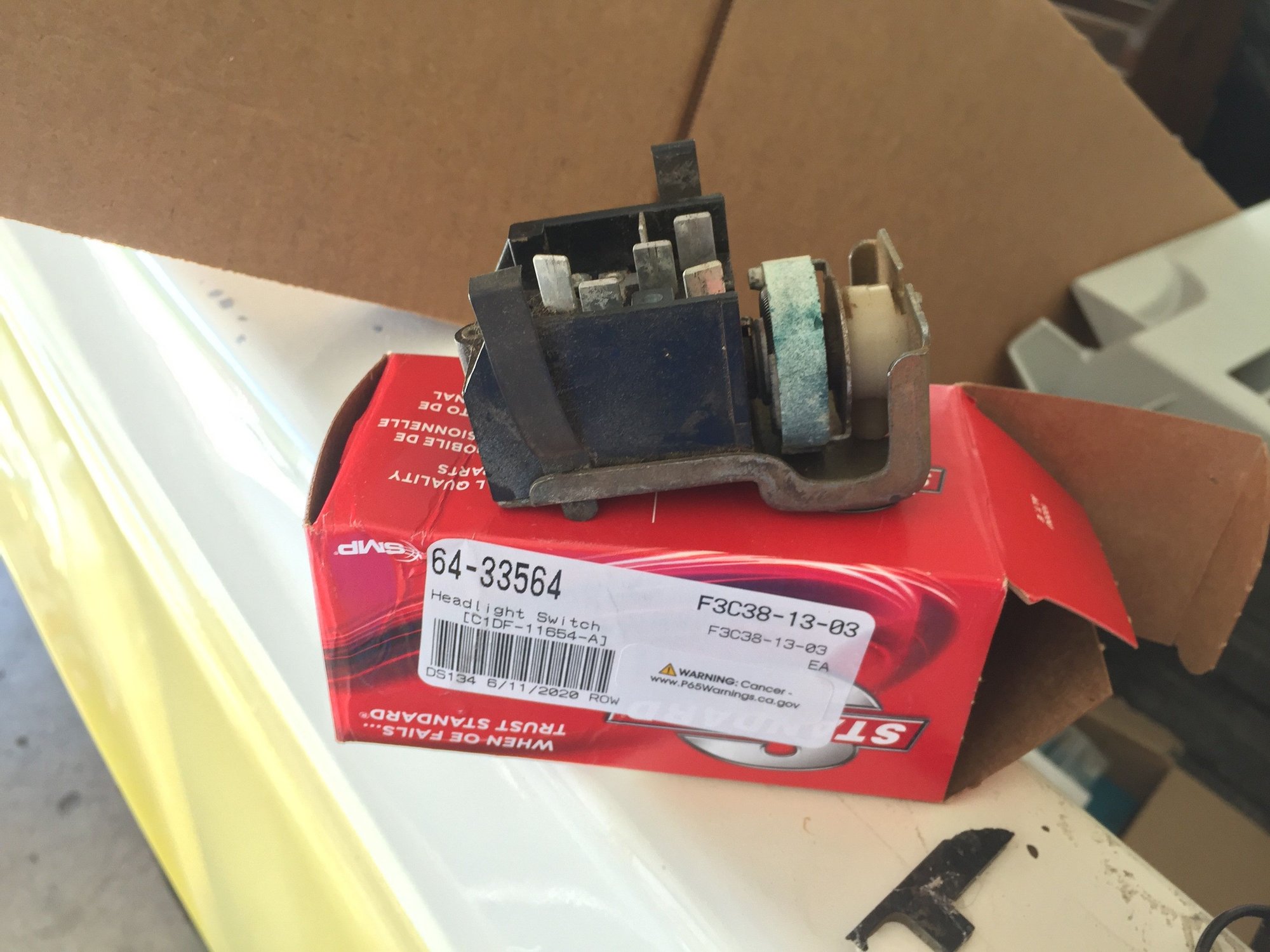

Update on the headlamp switch. As my dad always said, "you live stupid and you die smart". I ordered the new headlamp switch from Macs along with the **** that it says is "required". When they finally arrived I realized the **** does not even fit the headlamp switch. The switch looks identical to my old one.
The old switch
I knew my **** was bad because the plastic head spun when I turned the switch, and thought that could be the issue for not actuating the dome light also. I tried pulling the plastic head off the **** but thought I would break it, so I jambed a small piece of wire between the metal rod and the plastic ****. It cracked the plastic but seems to be holding.
I slipped a small piece of flattened copper wire in the gap between the **** and the arm
It solved the problem so I put the old handle on the new switch. One problem was solved - the front parking lights now come on when I pull the handle out. Never had that before. I can turn the handle to the left and get the "click" to turn on the dome light....but that did not work. I traced the wire from the dome light to the rats nest under the dash and was able to figure out the bullet connecter was not connected. I connected it and have a working dome light. Problem now is the dome light comes on as soon as I pull the light switch out, without turning the **** to the left to turn it on. Its just on. I traced the wire and its terminated into the fuse block as shown in the wiring diagram I have. Any ideas what to do next?
