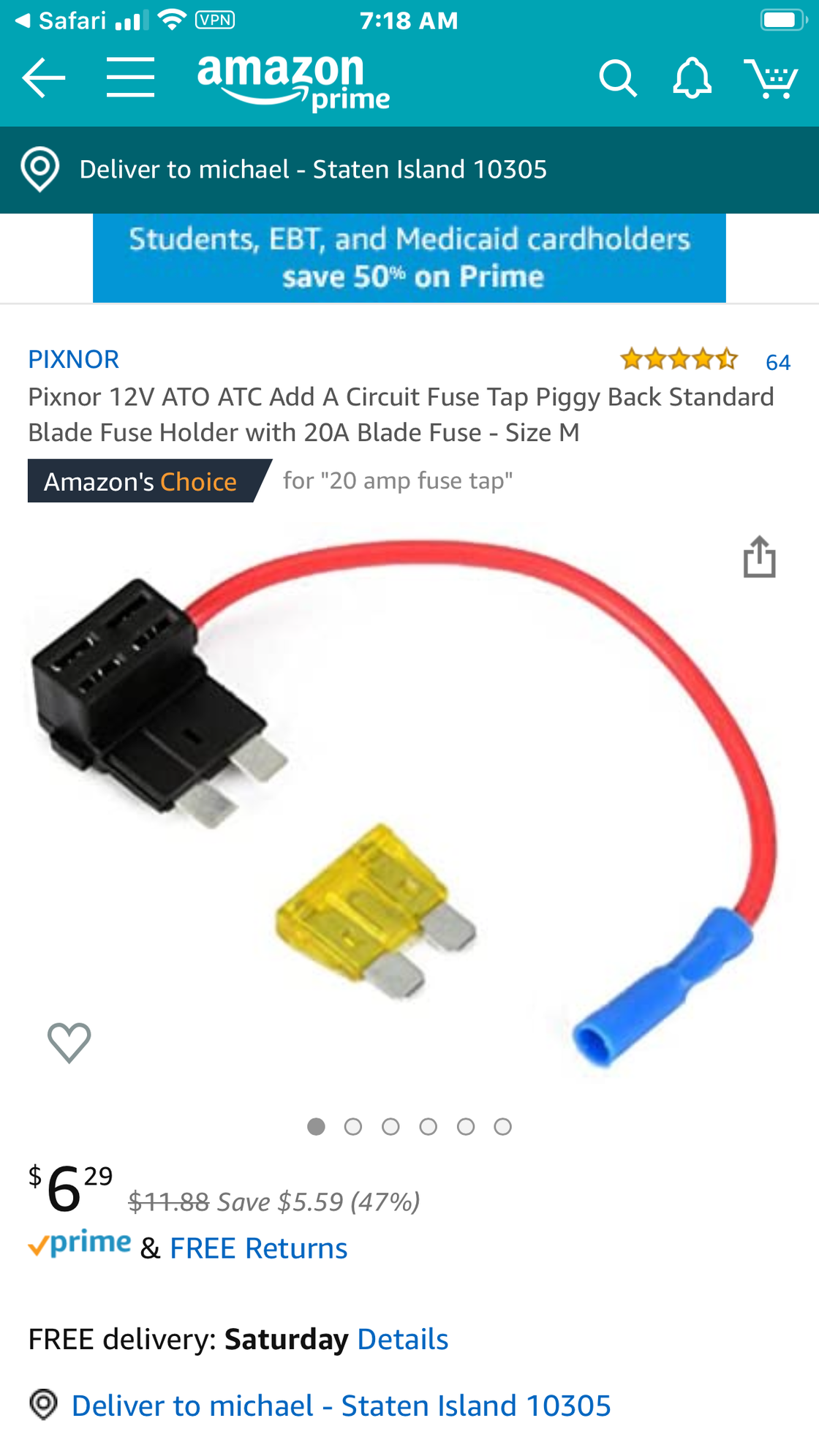

With one of these you can use any key’ed fuse position. Easy to disconnect as well.
