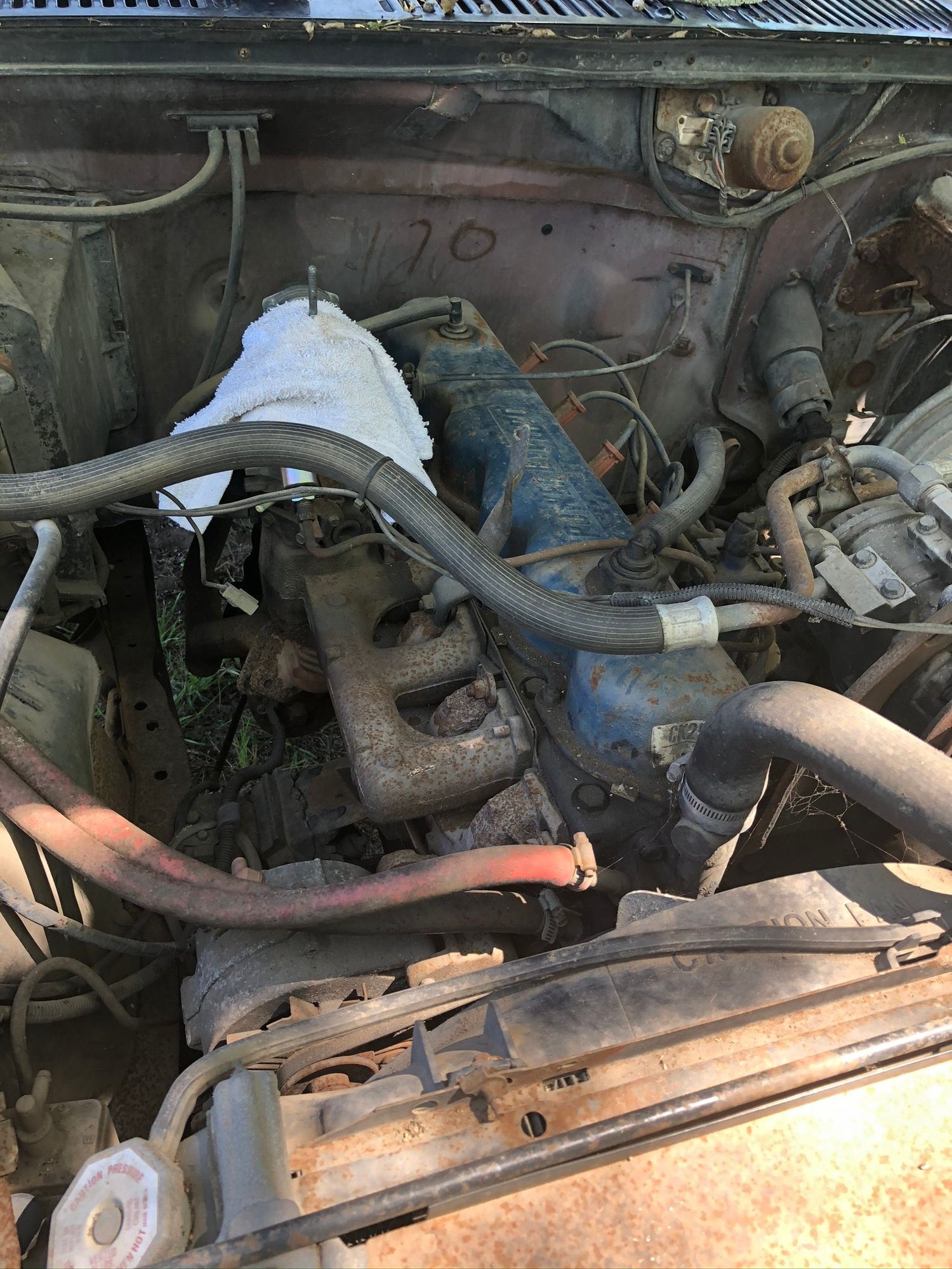

Locked motor
What ways could I fix this issue

You'll have to do some 'vestigatin'. Does the engine turn over by hand with a socket and breaker bar on the balancer bolt? Has it sat for a long time?
The more background you can provide, the better advice you'll get.

It’s sat for about 5 years, we have changed the battery, spark plugs, gas tank, and fluids. All it does is when I go to start it I hear a clunk. Tried to turn the balancer bolt with socket and wrachet and had no luck.

sounds like the rings are rusted in place. best bet you have is to pull the plugs and get a bottle of MMO mix it 50/50 with 10w30 motor oil in a oiler and put 2 pumps in each cylinder and let it sit over night. try to turn the engine by hand again the next day if nothing put another 2 pumps in each cylinder and let sit over night.
I did this with my 292 that sat for close to 33 years that was seized. took about 4 days of soaking to get the engine to turn over by hand. Been running ever since.

That's what I figured. Be patient. Remove the spark plugs and squirt a few ounces of Marvel's Mystery Oil in each cylinder. Let it sit a few days and put some more in. It may take a few weeks to loosen up. Make sure any old stale or varnished gasoline is removed, it will burn but it turns to glue inside the engine after shutdown.

In addition to the suggestions try to rig up your hinged handle AKA breaker bar on the crank shaft bolt with either a ratchet strap or a jack from under the truck to put a constant pressure on the engine.

Well, "worser" case if not worst case, would be a broken crankshaft or something like that. Marvel's is good stuff, but it ain't that good.
So kind of have to know some background. Do you know why it was parked, maybe some history from way back when from the former owner or whatever.

Worse case would be you have to rebuild the engine. It can get worse from there by how much damage to the engine but for now one of two things will happen. Either the engine will come unseized and will spin over which then brings the next question if it is mechanically sound to run or the engine will remain frozen in place which means it could have a bottom end failure that locked the motor up.

This is a good point, if it does free up, then it is wise to check the engine out carefully first before throwing any parts at it. Compression test. Cylinders will often have low psi on something that sat a long time, but it would be real good to know that there aren't any show stoppers lurking inside. Compression will come back up (if not too worn) with driving.
