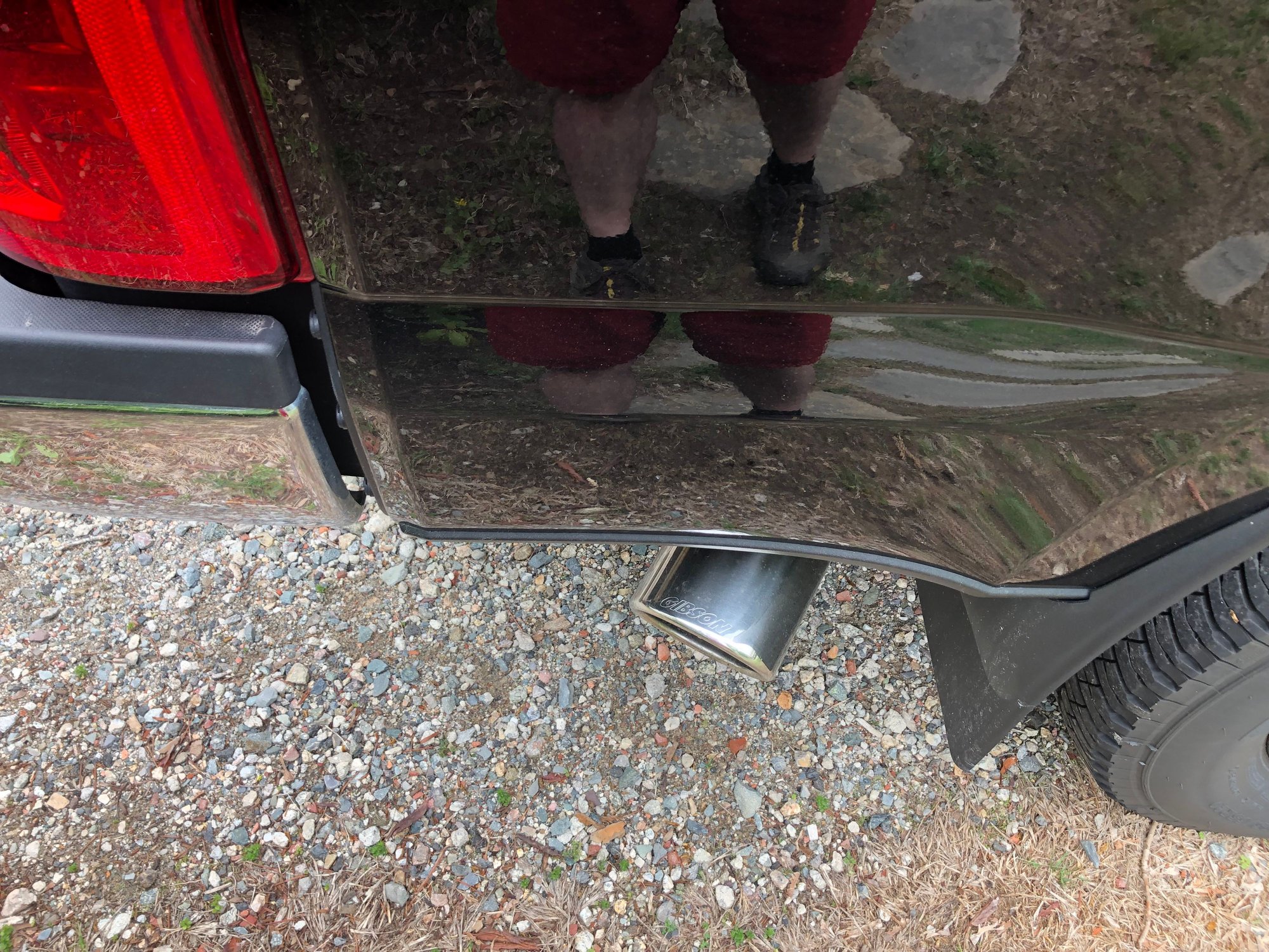

No photos yet, but I got the Gibson side swept exhaust mounted up yesterday. Directions said to cut the exhaust and take the old one out in pieces, I decided to fight with it and get it out in one piece. Worked out, but took a few hours and a lot of choice words. If you're planning on taking the exhaust out that way, I put the back up on ramps and had to put a floor jack under the frame behind the track back connection to wiggle it out. You also have to separate the small resonator from the muffler. If you have access to a lift, it won't be an issue, it'll come out in one piece no problem. I didn't want to cut up the old exhaust so, for me, the fight was worth it. New exhaust is subtle, lower note and only slightly louder than stock. It keeps the big resonators in place so no drone in the cabin up to about 55, haven’t been on the highway yet but I don’t anticipate it to being an issue. The kit replaces the small resonator immediately in front of the stock muffler with a straight-through 3" pipe. It exits the muffler at 3.5" and runs that out to a 5" tip.

Finally, got a few photos of the Gibson system and a short video of the cold start. I tried to do one in the cab but my pic isn't sensitive enough to hear any sound (it really is marginally louder than stock, just a deeper tone). The Gibson kit came with a 5" tip and I remember thinking there's no way I'm running this thing when I first took it out of the box. Once you get it installed, in my opinion, it doesn't look out of place since the rest of the truck is so damn big.

Looks great. Thanks for the comparison. If we all acted and thought alike it would be a boring world. Different systems for different wants and likes. I think the only way you can upload a video to this Forum is to upload to YouTube and post the link on here. I tried with no avail to get a video on here. Nice truck you have. 👍

Looks awesome. Is the Gibson system a DPF Back system or did you delete the truck? Does it sound better?
