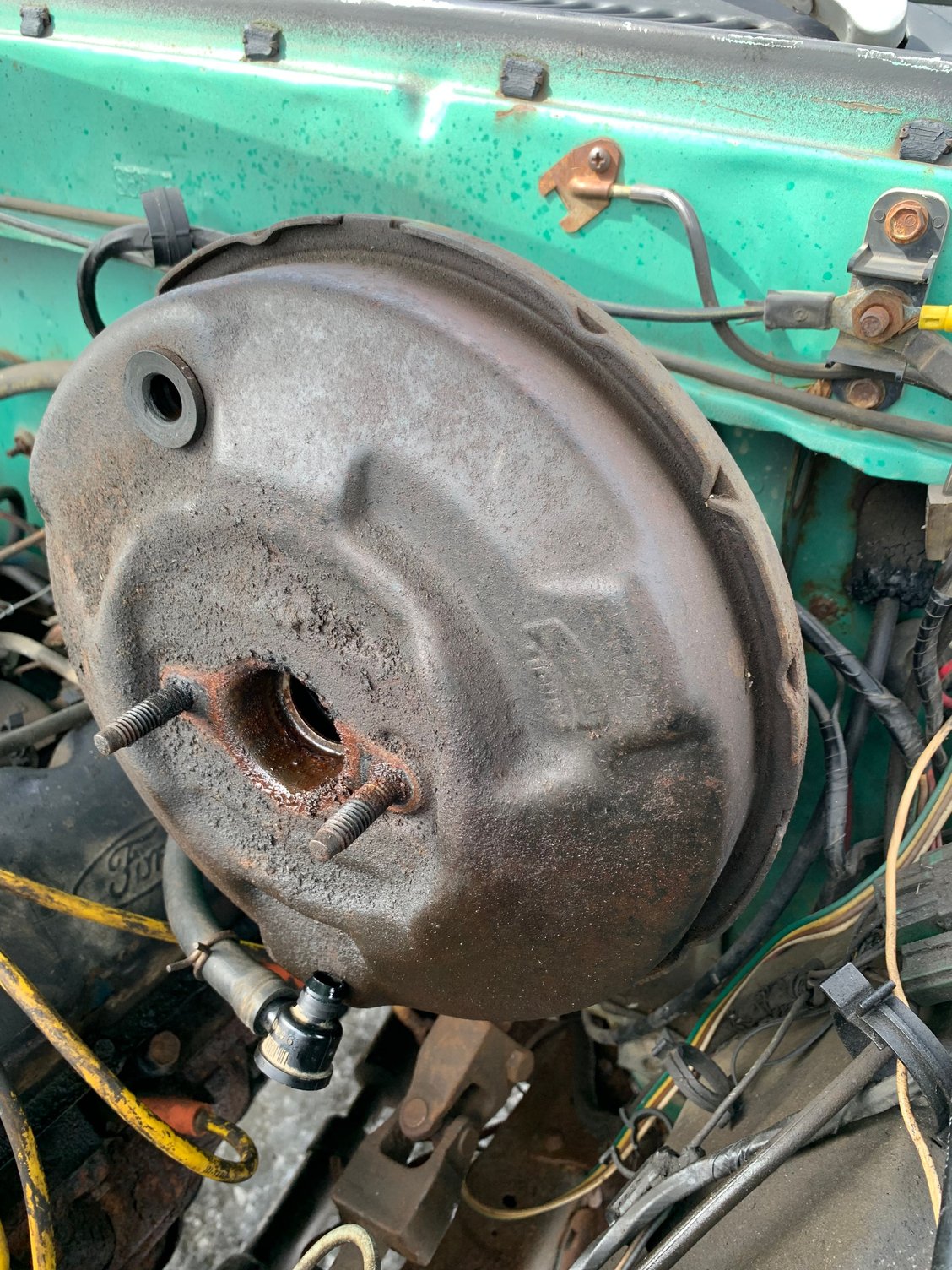

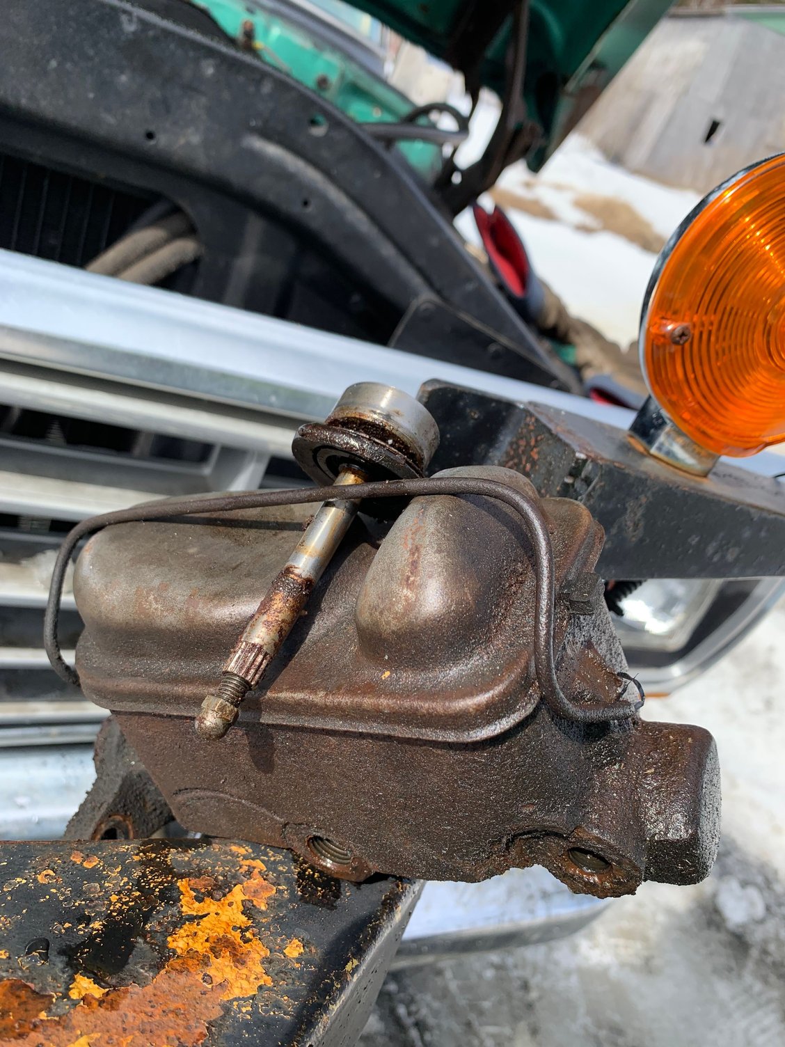

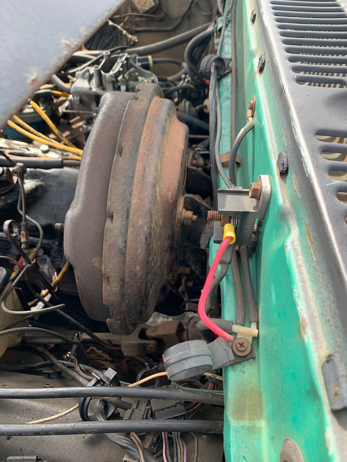

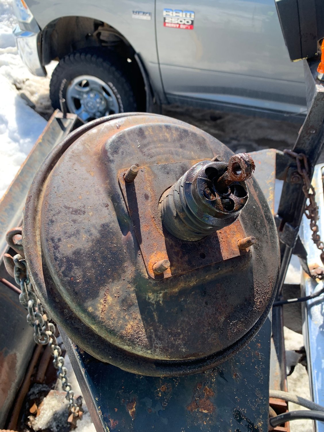

I understand people often have problems getting the correct brake booster for their application. Truck has a 1978 f250 camper special 2wd cab. I’ve attached a pic of the parts removed but I can’t seem to find any part numbers on either.
Is it safe to say that the only real difference is wether they mount to a bracket, or to the firewall itself? Or is there a pile of different ones?
Thanks in advance for any info.

Do you have single or double piston calipers and is your serial number (last 6 digits of your VIN) before or after DJ0,001?

All 1976/79 F250 2WD's & 4WD's have dual piston calipers & 12" x 2 1/2" rear brakes.

the frame and drivetrain is actually a 79 f150. Had a rusted cab so there was a 78 250 cab put on so I’m assuming they left the 78 booster and m/c intact.
What are the difference in the 2? Bigger reservoir for dual pistons? Or different line configuration?

Brake booster
Fits:
77-79 F250 2WD w/ dual piston calipers before s/n DJ0,001
P/N D7TZ-2005-B
In case you have cruise D7TZ-2005-C
